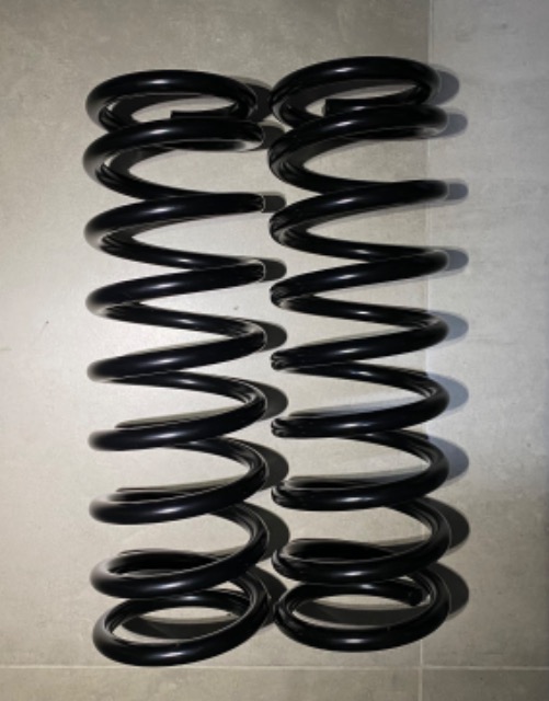

05 Jan 2024 16:41 #253272
by Joejimny7
Replied by Joejimny7 on topic Gen4 leaning after lift kit install - what to look for?
Again my apologies on the late reply.
It took me a long time but finally got the rear springs replaced with the Jimnybits springs. Lean is gone, ride is smoother, on the back of the car height is lower which makes it look more even.
This was a good move and in the future I might replace the front springs too as I liked the smoothness of the Jimnybits rear springs.
