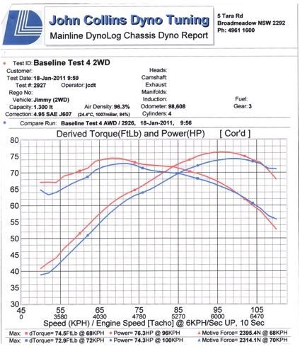

Replied by DrRobin on topic Stiffer springs than stock = better???
Most engines reach peak power before peak rpm. Power is limited by the problem of getting the fuel/air in and the exhaust out, so along with stronger con-rods, valve springs, high lift cams, etc you might also be looking at inlet and exhaust manifolds as well as a high flow air induction system, it's all going to start adding up.
Then the other problem is gears, most high reving engines have a narrow power band, that means more than 5 gears to keep the engine in the sweet spot.
