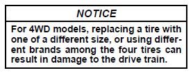

I didn't know you wanted a report on wear, but, I'm one of those who previously stated I rotate in a 5 tyre rotation every six months and the reason I do it is to even out the wear, experience has taught me that the tyres WILL wear unevenly if they are not rotated - on MOST vehicles the front tyres will wear faster than the rear, and if it's a front wheel drive vehicle, you're pretty much guaranteed, that the fronts will wear out long before the rear.
You don't HAVE to rotate, you can replace one pair of tyres and leave the other where they are, you can fit new tyres on the rear and transfer the part worn rears to the front, but, I like a matched set of tyres, so I rotate and replace as a set.
If you're going to run a 4WD, and use the 4WD, it's a good idea to rotate in a 5 tyre pattern so all 5 tires have the same approximate diameter and if you're driving AWD, say something like the Vitara LX, you'll find that there's a warning in the owner's manual about running different brands of tyres, which pretty much means you HAVE to rotate, and yes, the manual also recommens you rotate.
