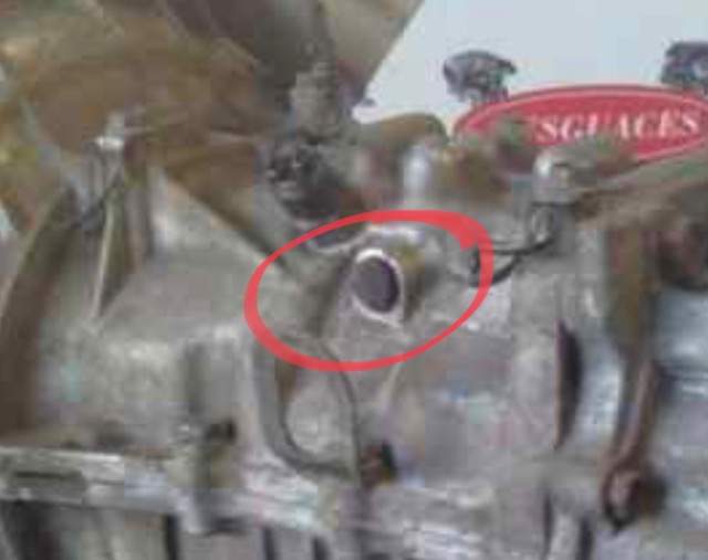

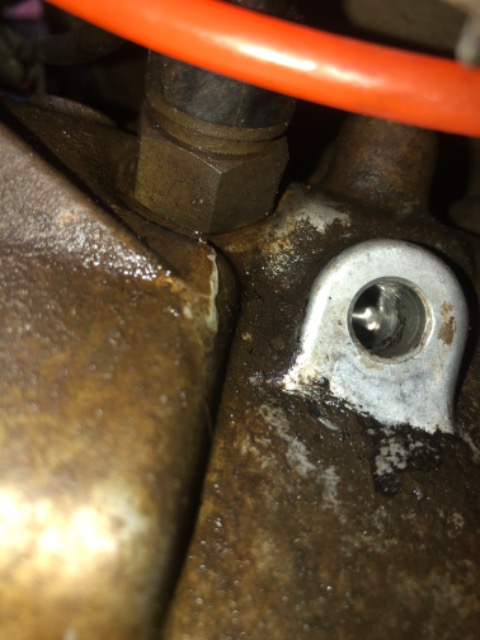

I have a new oil lean on my gearbox and wondered if anybody had seen same issue. We noticed a burning oil smell, on checking there was a stream of oil down the side of the gearbox ( about half way down), dropping onto the catalyst. Getting a mirror and it seems to be coming from a hole on the top, looks like a cross drilling for assembly of detents. Looking online for picture there should be a bung in there (see picture). I contacted Suzuki but there is no replacement part - going to try and block it off, what I can't figure out is why after 80k does it decided to fall out. Anybody seen similar issue? I did get the parts department to talk to the workshop and they said they had seen similar issue on Vitara and they just something to block the hole.

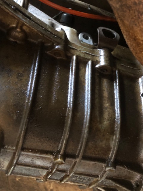

Here's my gearbox. Easy to see with NSF wheel removed..
I decided to plug with a bolt and some JB weld. Hopefully it will hold until I can find a proper bung (did think about using a cork as well).

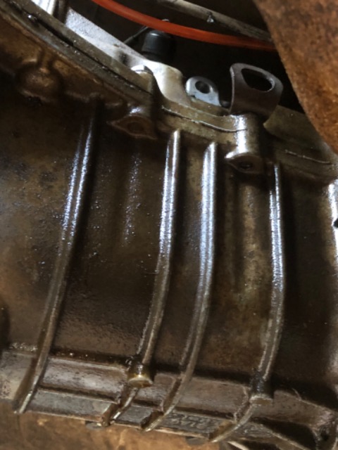

Fairly common, and not just on Jimnys, I've had it happen on both first & second generation Vitara/Grand Vitaras.
Whoever told you there is no replacement part is either too lazy to look it up, or doesn't know what to look for - it's a rubber plug, P/N #09250-10006 - USD$1.68 from megazip in Japan. As far as I know, it's the same plug on all three models, it closes a drilling used to insert the interlock detent balls.
I would suggest you not JB weld a bolt in there, a rubber or plastic plug with a smear of RTV sealant is preferable, you might need to remove it at some point.
