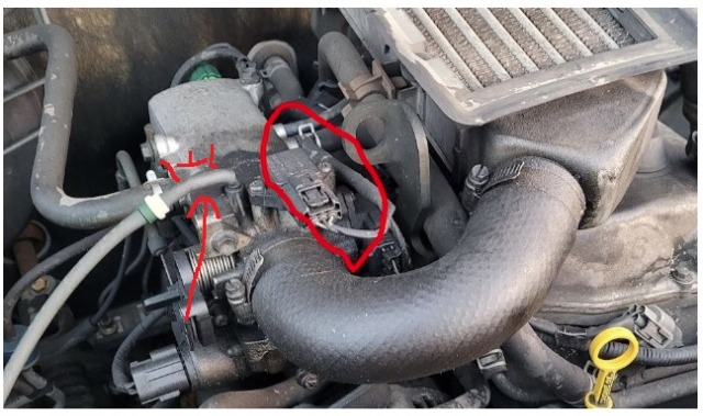

by Matt889
Can someone Please help me? I have purchased a turbo gauge for my Jimny but I don't know what line I should put the T-fitting into to read the turbo levels, I have a feeling my turbo is not working but I don't have a way to test or diagnose it without seeing it on the turbo gauge. Appreciate any help!

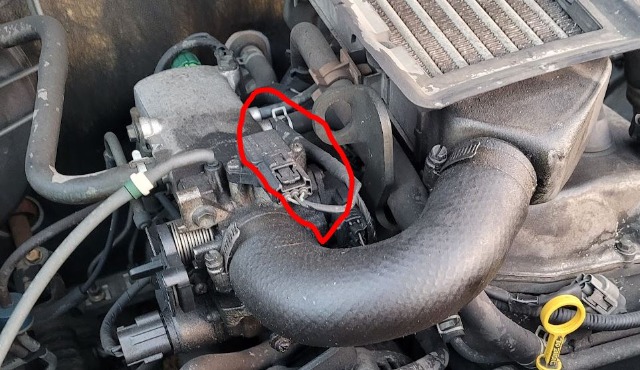

13 Dec 2022 00:08 #246341
by fordem
Replied by fordem on topic 1999 Suzuki Jimny (JB23w) 660 Turbo Gauge install help plz
That is where I'm suggesting it might be possible to fit it.
Remove the pressure sensor and disconnect the tube, blow through the tube fitting and see if the air comes out of the pressure sensor port - if it does - fit the tee there.
