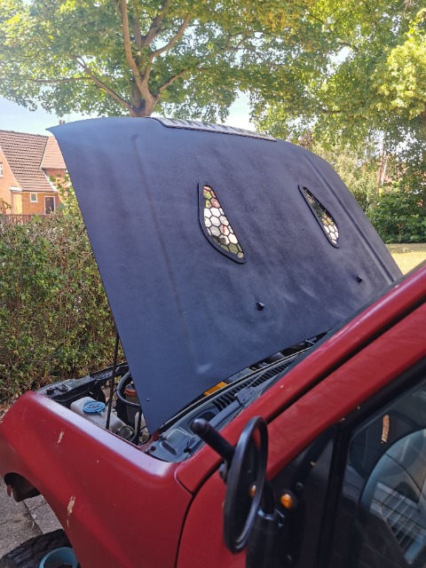

yeah the m13a doesn't have an oil temp sensor, but i'm having an aftermarket one installed and an indicator, maybe i'll just use 10w40 to see if it's better, otherwise i might try 10w50? hoping it's not too thick
also my water temp is always in the middle even after pushing a lot, even though the engine bay is pretty warm in that case and i tend to stop and let the engine idle with the hood opened to help it with the temps, you know, just in case
