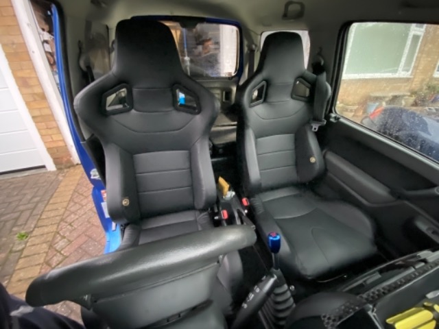

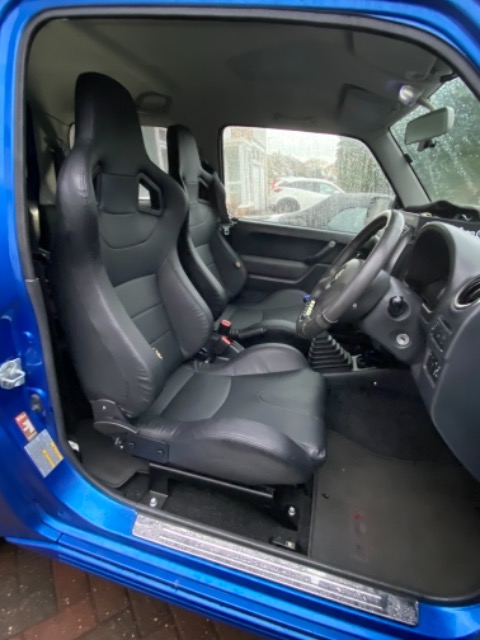

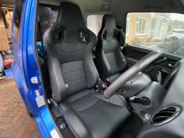

New seats fitted, about 3 hours on Sat and slightly longer today. The need to be positioned just right, side to side to clear the door and also plastic trim round the hand brake, this took a couple of dry runs and then drill some new mounting holes in the sub-frames.
They are about the same height as the original seats, so the driving position is much the same, but they have much better back support and a short test drive suggests they are more comfy than the originals, time and a long journey will tell.
Overall very pleased, a good call JackonlyJack.
The sub frames added a fair bit to the overall cost, but we’ll worth it to avoid hacking the original seats and welding in new cross members.

23 Oct 2022 18:13 #245542
Replied by jackonlyjack on topic Any good racing seats that fit my 3rd gen?
They look spot on Pal
Think I will change my seats again next year
After doing a trials other week on a really demanding course my old body can't take the minimal padding on the BB5's
Could you please tell me the seat mounting measurements for the BB6
to see if they will fit my subframes

24 Oct 2022 03:18 #245551
Replied by Lambert on topic Any good racing seats that fit my 3rd gen?
Those look great!
