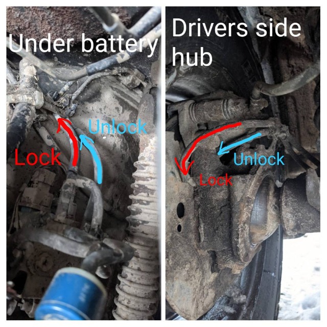

Hello! I just got my very first 4x4
I was awere that 4x4 is not engaging when I was buying it - it's time to fix that. I've seen topic about troubleshuting flashing 4wd light and found an issue. I have no vacum hoses at all :'D It seems I need to rebuild it more or less. I found this under the bonet - so it seems not whole system is missing.
Does any good soul has some photos how it should be connected? Diagrams are not very easy to read when I assume that everything might be messed up.

02 Feb 2022 09:34 #241673
by Sharik
Replied by Sharik on topic Hubs vacuum pipes diagram/photos?
It seems that maybe someone tried to replace whole system but ended up with "nah, I actually don't need 4x4". There is loop between lock/unlock ports (at least it was not sucking dirt), none of those alu pipes, rubber pipes closest to hubs are also missing (but plugs are not secured, so I guess I will have to clean those inside).
It seems those are original, vacuum hubs - no any kind of handle.
