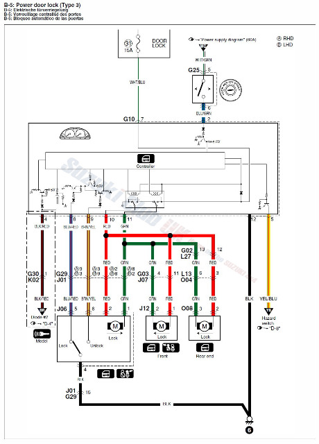

This is the wiring diagram for the central locking
There is no input from the internal light system. There are inputs from the ignition switch, the key (this might be the remote) and from the drivers door, so it might be the internal light is a red herring and you need the signal from either the ignition or drivers door.
Does it auto-lock if you open the passenger door?
