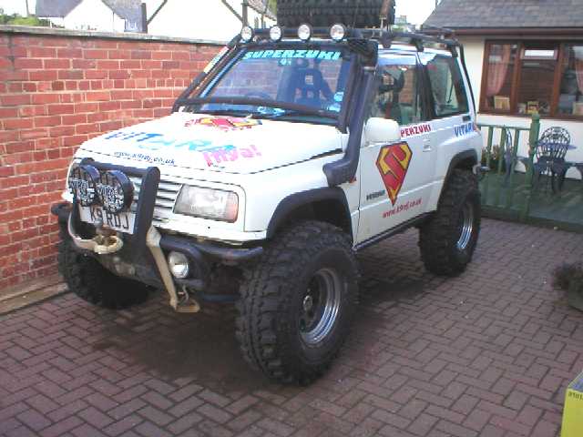

03 Aug 2020 21:10 #226054
Replied by X8GGY on topic Minimal Off road Jimny Rig
The following user(s) said Thank You: Tom Bacon
- Posts: 3727
- Thank you received: 923
03 Aug 2020 21:20 #226055
