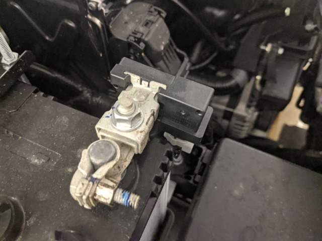

The 2020 Jimny has a sensor/shunt fitted in the negative circuit of the battery. This feeds back Voltage/Current/Temperature information to the ECU that then controls the alternator charging via a LIN circuit. Nothing particularly clever such as "stop/start" etc in the Gen4. but probably would form the basis of a more sophisticated system in one of the other cars in the range (they re-use tech across the ranges)
