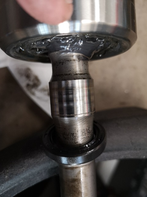

Front hub oil leak with new seal

Replied by Jimx5 on topic Front hub oil leak with new seal
I can see the groove/corrosion on the shaft but i don't think the seal lip sits just there.
Can i ask if you sourced a correct seal which should be 9mm wide, i once fitted an e-bay special which was 7mm wide and it leaked like a sieve, new correct seal from Jimny Parts sorted it.

Thanks for your reply.
I took a look at the seal, it says 26x38x6 but when I measure the height it seems to be 7mm.
The kit I bought on Ebay is supposed to be eqvialent to 09283-26016. I think the kit on Bigjimny was sold out a couple of weeks ago, that's why I ordered it from Ebay instead.
I've already a new 8mm seal, hope it will be fine.

09 Jun 2020 22:17 #223423
by Roger Fairclough
Replied by Roger Fairclough on topic Front hub oil leak with new seal
The genuine Suzuki seal Is able to flex to allow for the movement of the shaft from it,s centre line as the hub moves to allow the Jimny to turn on the road. Generic seals are not built to do this so as you drive through a bend the shaft pushes against the lip of the seal, opens a gap and oil will pass through into the hub.
Roger
