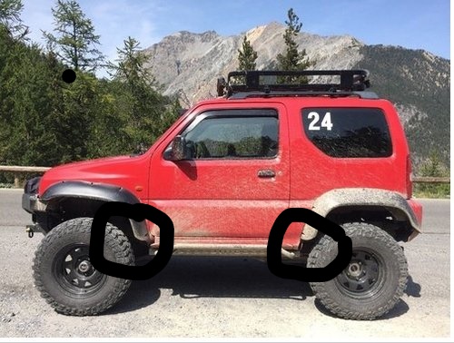

1 The rear axle will be moved slightly forward, The front axle will be moved slightly to the rear, due to the arc of the radius arms. Longer arms will address this.
2 Caster bushes fitted correctly will only rotate the axle, not move it's position unless fitted like Dave has done.
3 Due to the lift, If using standard panhard rods the axle will no long be central longitudinally.
A bad drawing of where it will most likely be rubbing.

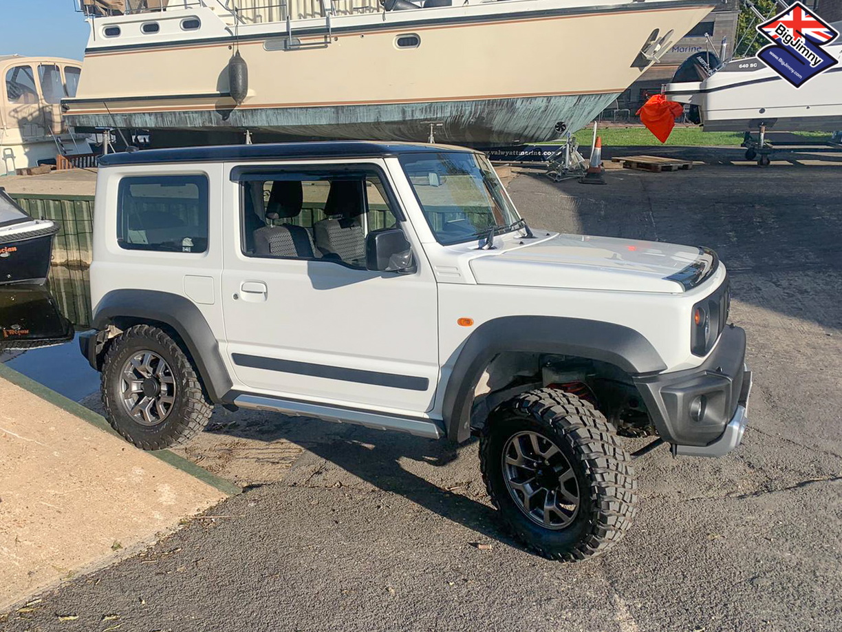

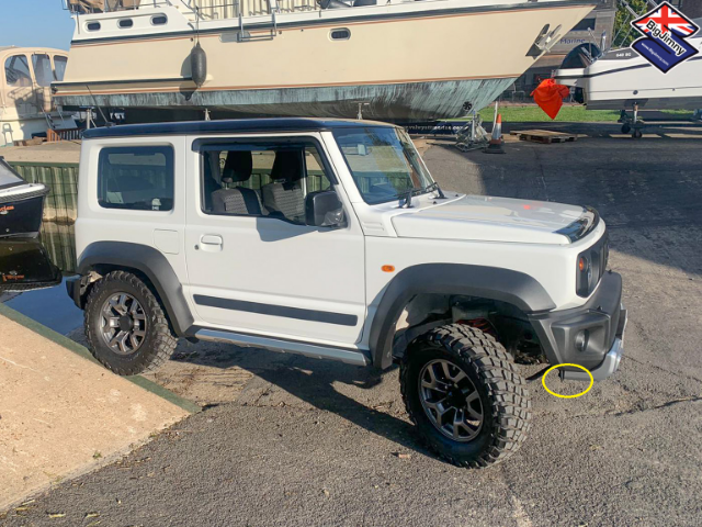

15 May 2020 14:01 - 15 May 2020 14:02 #222272
Replied by mlines on topic Tell me about - wheel position in wheel arch
Thanks,
This is the sort of space we have
The front is deceptive in the picture as the tyre is inside the arch so should not touch the bumper edge under compression (we tried)
My feeling is that it is this small "mudflap" style rubber piece which is inside the wheel arch
This is where we have seen it get close. Cannot quite understand why this has appeared following a mild lift
