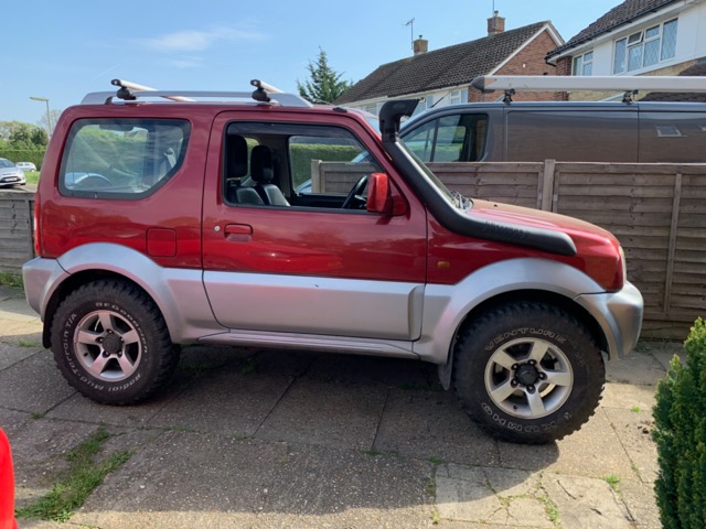

11 Apr 2020 17:40 #220963
by Lccsw
Replied by Lccsw on topic Newbie question on fitting lift spacers
thanks, all done today. Just had to remove 3 other screws at the bottom of the bumper to get the to anti roll bar bolts.
The front shock bolts were a little bit tough but got there in the end, also fitted the steering damper i had so a good afternoons work.
next up tomorrow is the snorkel
