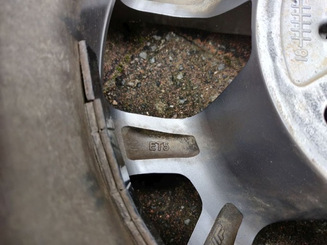

by Gadget
Replied by Gadget on topic Gen 4 - Steel Wheels
Standard Gen4 alloys are ET5 - photo of the markings on the rear of mine below. I think you're right Lambert - going from ET5 to ET0 moves the wheel away from the suspension.
- Posts: 9243
- Thank you received: 1855
24 Mar 2020 15:45 #220218
Replied by Lambert on topic Gen 4 - Steel Wheels
This is unexpected. Useful though as it suggests that all wheels are interchangeable across both generations 3 and 4. There was a suggestion that they were et22, makes more sense that Suzuki would keep as much as possible the same as it reduces production costs. Do we now have to investigate the alleged track width incr?
