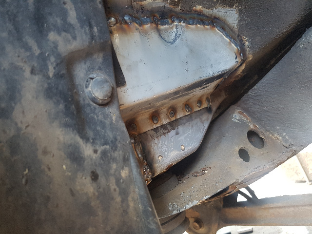

13 Jan 2020 13:02 #217230
by RogersJimmy
Thanks for your helpful replies. Here are a couple of pics of the two worst areas, the one by the front outrigger being the most tricky to access.
Replied by RogersJimmy on topic Rusty around body mounting outrigger
Keithy wrote: They do tend to rust slightly eh!
Take some pictures and post back....I've just about built a complete Jimny by weld repairs....is it this area?
13 Jan 2020 13:17 #217231
by Keithy
Replied by Keithy on topic Rusty around body mounting outrigger
One looks straightforward but the other needs the body lifting
not fun but if those are the only rot sites it's not too bad.
The following user(s) said Thank You: RogersJimmy
- Posts: 10028
- Thank you received: 2004
13 Jan 2020 14:14 #217235
Replied by Lambert on topic Rusty around body mounting outrigger
I personally think that lifting the body like Keithy suggests is the best option. I would not be happy with an mot garage cutting off and rewelding the outrigger unless they are some kind of classic car restoration place. I've had to repair one too many mot garage weld bodges.
