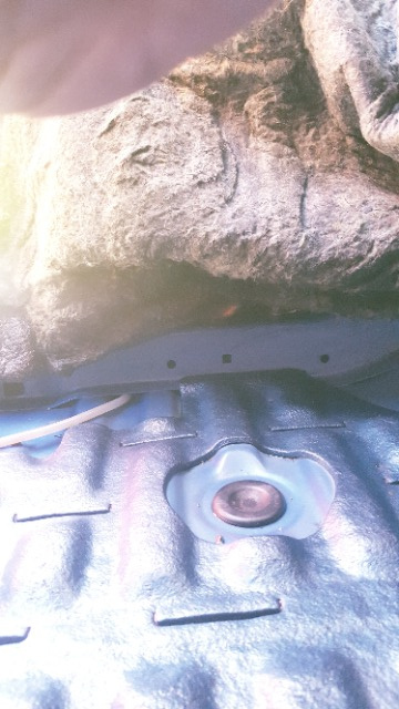

Hi all.
New to the Jimny scene. 00 with 197k miles.
Cleaning the inside yesterday, 1st time scince I bought it 3weeks ago I noticed the carpet in the drivers footwell was damp. I've gone through the bits that I found on line - windscreen drain off, back wiper hose, heater index rubber bungs - all to no avail. It doesn't seem to be coming from anywhere in the front. I have the carpet up and the water is coming from under the driver seat. I've had the carpet up in the back and it's dry.
Anyone have ideas of what this is from? She's not gone off road or through any puddles. It has been raining but the rest of the car is bone dry. This is coming from the bottom up.
I've attached a pic of where the water is coming from.
Thanks
Andrew

27 Oct 2019 13:15 #215168
Replied by Riccy on topic Driver side footwell
There is a join on the pipe going to the rear screen wash under the driver seat. Maybe take the seat out and have a better look. If thats broken it would explain the water (even if the rear screenwash isnt used).
- PandaJimmy
27 Oct 2019 13:24 #215170
by PandaJimmy
Replied by PandaJimmy on topic Driver side footwell
Cheers mate. Didn't go any further as there is water coming out the the back window. Might be easier to disconnect altogether and plug the hose in the footwell. Not overly concerned about having the rear screen wash....
27 Oct 2019 13:27 #215171
Easiest place to disconnect it would be at the screenwash bottle under the bonnet. It will need plugged or all your screenwash will piss out where the pipe was removed.

27 Oct 2019 15:35 #215173
by PandaJimmy
Thanks bud. Have that disconnected now, disconnected at back door and drained hose too. Fingered crossed that does the trick.

27 Oct 2019 16:00 #215175
Replied by Daniel30 on topic Driver side footwell
Once dry, sprinkle some talc around the area its a bit messy but if it happens again it will leave a trail so you track it better, that's what I done and found it coming from the passenger side corner of the windscreen were auto screen hadn't sealed a new screen properly
