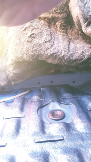

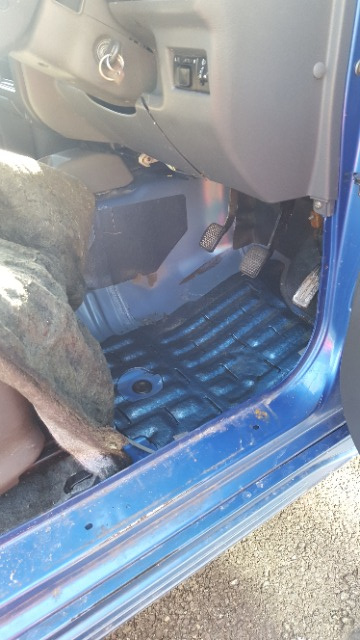

Hi all.
New to the Jimny scene. 00 with 197k miles.
Cleaning the inside yesterday, 1st time scince I bought it 3weeks ago I noticed the carpet in the drivers footwell was damp. I've gone through the bits that I found on line - windscreen drain off, back wiper hose, heater index rubber bungs - all to no avail. It doesn't seem to be coming from anywhere in the front. I have the carpet up and the water is coming from under the driver seat. I've had the carpet up in the back and it's dry.
Anyone have ideas of what this is from? She's not gone off road or through any puddles. It has been raining but the rest of the car is bone dry. This is coming from the bottom up.
I've attached a pic of where the water is coming from.
Thanks
Andrew

27 Oct 2019 13:15 #215168
Replied by Riccy on topic Driver side footwell
There is a join on the pipe going to the rear screen wash under the driver seat. Maybe take the seat out and have a better look. If thats broken it would explain the water (even if the rear screenwash isnt used).
- PandaJimmy
27 Oct 2019 13:24 #215170
by PandaJimmy
Replied by PandaJimmy on topic Driver side footwell
Cheers mate. Didn't go any further as there is water coming out the the back window. Might be easier to disconnect altogether and plug the hose in the footwell. Not overly concerned about having the rear screen wash....
