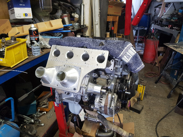

Last turbo I fitted to a Jimny spooled up to 15PSI @ around 1200RPM a popular misconception propagated across the internet is that a lag monster is created when adding a turbo to a NA engine......strange.
I tried a turbo on the M16A with 10.5:1 CR.....not happy at all......Compression needs lowering to make use of any boost.....is yours the M15A.....has 11.0:1 CR.....no elbow room.
Supercharger and big mahoosive laggy turbo next for me.
