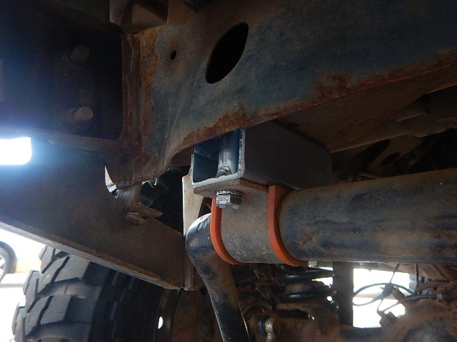

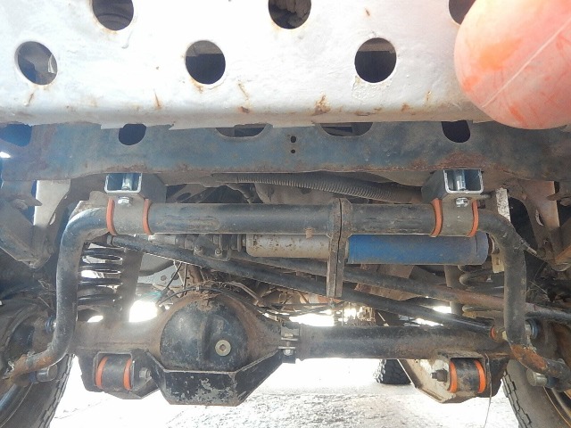

hello all, i had an advisory on MOT that the anti roll bar D bushes had play in them, i was thinking of replacing them but after reading up
some folk take the roll bar off completely , so then thought its not worth bothering if they only have a few mill play ? i,m not exactly cornering at 80mph, am i thinking right on this? whats folks thoughts ? cheers Liam.

Removed mine 3 years ago
You get used to how it feels
If you're running a suspension lift you will need extended brake lines
to cope with axle articulation off road

Some MOT testers notice its absence. Not sure what that results in, but if you take it off it might be best to blank off the bolt holes and paint it to look like theres never been one on

They are as cheap as chips even for genuine Suzuki ones and not hard to replace, you have to remove more bits to take the bar off.
So if you are mostly on road it's going to handle better with it.
If you have a lift, big tyres and want articulation then take it off.

When I had the 90 it was a thing to remove the anti roll bars from them, so I did because I was young and foolish. They were back on within the weekend. Didn't like feeling like I was going to fall off the road with every bend. As has been said, new ones are cheap and plentiful and easy to replace.
