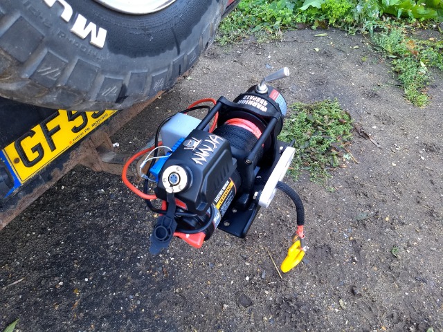

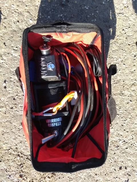

For occasional use I have this.
It's a 4,500lb winch on a tow ball mount with jump lead style cables long enough to reach the battery, all packed into a convenient tool bag. I got a good deal from a forum member but a similar setup new wouldn't cost a fortune.
It's perfectly adequate for self recovery, can be used on any vehicle with a tow bar or tethered to any fixed object. It lives in a clean, dry area rather than sitting outside getting exposed to all weathers regardless of whether you're using it.
Just another idea if you want a winch but you're not expecting to use it all the time!
