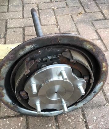

26 Nov 2018 07:30 #198169 by X8GGY
Interestingly though, and if it inspires more confidence, I've recently fitted another pair in a new (secret winter) project -
And I haven't welded these studs on... I figure this one won't get so much abuse as S200KYS, and this one has drum brakes so the flanges are protected from the elements (S200KYS has a disk brake conversion so the flanges are open to the elements?)
Dave

26 Nov 2018 11:08 #198173 by OlaGB
S200KYS wrote: Interestingly though, and if it inspires more confidence, I've recently fitted another pair in a new (secret winter) project -
Dave
Thanks Dave! I`m also still running drums, and will keep on doing that.
I guess they should be fine then, if you havent heard about any others.. Youve been around here alot longer than me, so you would know i guess :)
