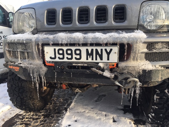

I have ordered the JB winch cryb with tow points, but havent seen much pictures of it installed..
Anyone got pictures with and/or without bumper?
Mounts with and without tow points are interesting to see.
Would also be interested in seeing how far out the tow points and rollers/fairlead stick out

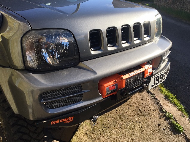

I fitted one of them. got a 13,000 lb winch mounted on it. Modified the clutch lever through the bumper for ease of use...
Fairly straight forward fitting it all, a little drilling through the chassis rails for the bolts..
Wanted the not in your face look.. Also fitted the rear hd recovery points. they protrude about the same amount through the rear bumper.

The black bar below it is home made, but thats the jimnybits winch tray and tow points fitted and with a winch on. Dont have any pics without, but theres plenty of room for it. I have a 2" body lift also which helps with the room a fair bit, though the winch clutch lever can be front mounted on my winch, which means it would work without the body lift as well.
and ive since moved the number plate which helps protect the winch a bit...
Replied by Riccy on topic Jimnybits winch cryb, anyone got pictures?

A bit dissapointed as i was hoping it would keep the farlead flat or even a bit into the bumper.. Sticking out of the bumper is a MOT fail over here in Norway..
Maybe i`m able to modify it some, well see when it shows.. Should be right around the corner!

These pictures might help. From memory it would be hard to easily mount the winch further back on the JB mount but may be possible if you’re creative. There’s space for the winch further back but, from memory, possibly not enough room underneigh for the mounting bolts to be further back.. if that makes sense? If you need the mount itself to be further back then possibly a harder puzzle still. Might be easier to fabricate something?
