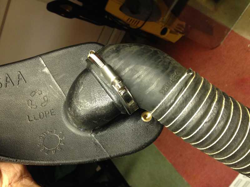

  • Vinnie
15 Nov 2014 22:06 #129651 by Vinnie
Replied by Vinnie on topic Short snorkel fitting
Leathery1 wrote: Supplier siad thats the trade off when you buy a cheap snorkel!
I wasnt impressed with that response but it can work really well. I didn't buy it for the price but cos I prefer the look of the short one, dont like the big plastic pipe down the wing.
Took a bit of plastic welding and some big jubilee clips to get it right but is well sealed and a neat job.
Yep that's why I brought it just thought it looks better.Think the other one is £20 more ?? so price wasnt the issue ,But the kit how its supplied is not good I know Dave is only supplying them and not making up kits so I've got no gripe with him, but that flex pipe with reinforced wire is to big to fit to the existing plastic and certainly won't fit to a oval hole which the circumference overall is much smaller.All it needs is a rubber pipe with two 90 degree angles job done

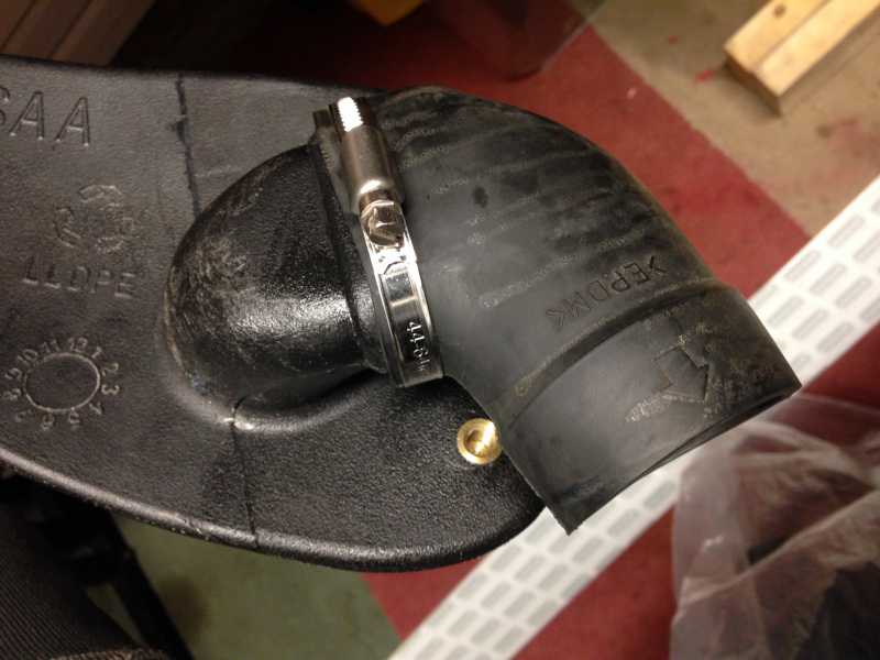

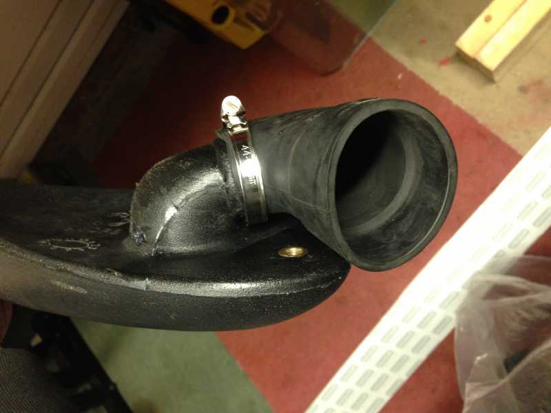

  • Vinnie
19 Nov 2014 17:19 #130036 by Vinnie
pgatensuk wrote: I've yet to fit mine, but did have the same thoughts, that fitting a flexi pipe to oval plastic might be troublesome.
I brought mine after reading Zookfastback's review and then dave doing a deal.
Just not had time to fit.
Hopefully it won't be as difficult as it seems.
Fingers crossed.
Paul
Hi Paul
I ended up using the old 90 degree inlet angle it fits a treat around the oval part
Then cut the straight section of the old plastic piece from under wing liner for sleeve to stop crushing then fitted the flex to that
Will change that flex for a rubber pipe as it was temp as was laning on Sunday and needed it on
Cheers vinnie
