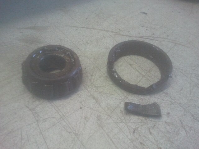

i had no movement in mine but oil on the swivel hub so changed and found this
no mement in the other side or oil on the swivel but for the cheep price im doing that side soon also i noticed the bottom was knackered but top looked ok dont know if for a bit of a bodge when doing one side you could hop to the other and stick the top one you just removed in the bottom of other side got to be better than the one thats proberly in there now
