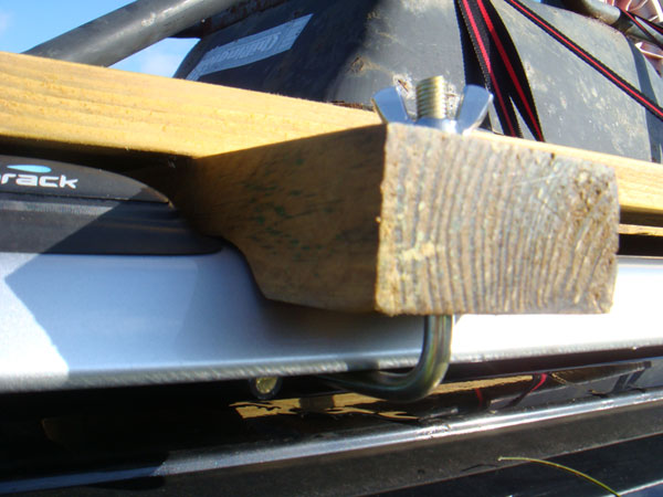

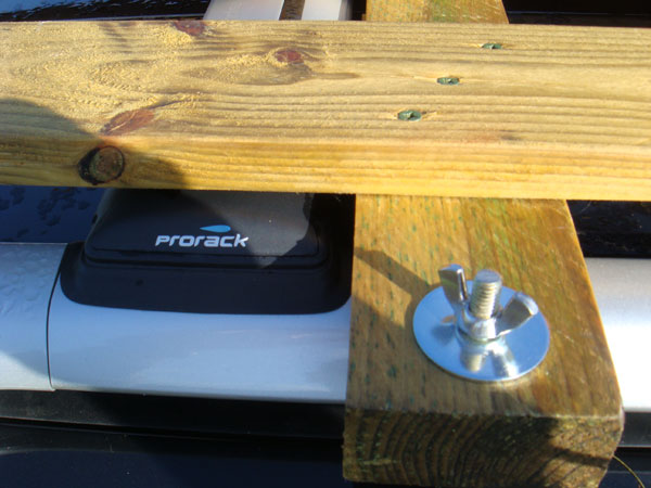

by Halford
Replied by Halford on topic Securing waffle boards to roof rails - how?
I used P bolts and bent them in a vice to fit as shown below - quick on/off
also put a bit transparent tubing over the P so it didn't mark scratch

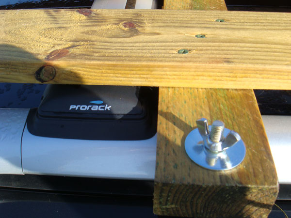

by JerseyJimny
Replied by JerseyJimny on topic Securing waffle boards to roof rails - how?
Try your local welding and fab shop for some 1 inch box bar
couple of exhaust clamps like above and bobs your uncle DIY Roof Bars
