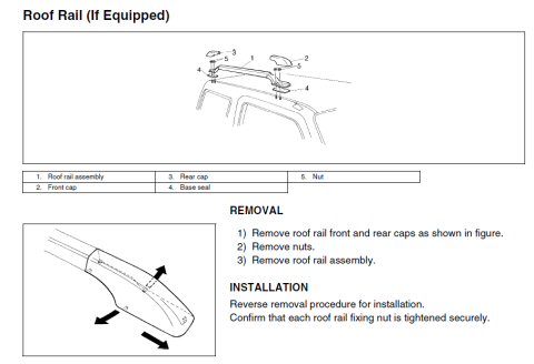

its may be a simple thing to do but id rather ask than break some thing :ohmy:
my question is if any one can help is how do you remove the plastic end caps on the roof bars with out breaking them also does any one have any end caps lying around :cheer: :laugh:

Replied by dirtydogz on topic roof bars
Hope this helps you
dirtydogz.
