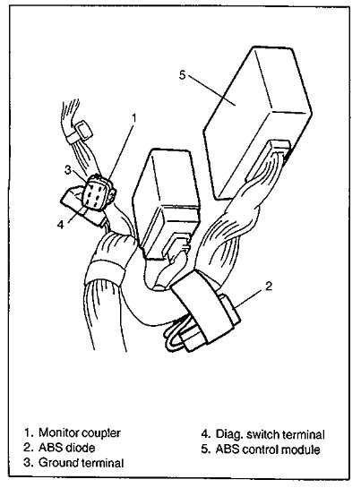

The socket fixed under the dash is the data link connector, that a Suzuki scantool plugs into.
The manual shows the "monitor connector" as a small socket dangling from the harness next to the ABS controller.
I don't have ABS, but the picture in the manual shows it on the drivers side. This could mean up under the dash, behind the side kick panel where the speaker grille is, or even inside the engine compartment near the battery.
I'd start by lying on the floor and looking up above the pedals, then try removing the side panel- the door step trim has to break off first (it will snap the clips off).
