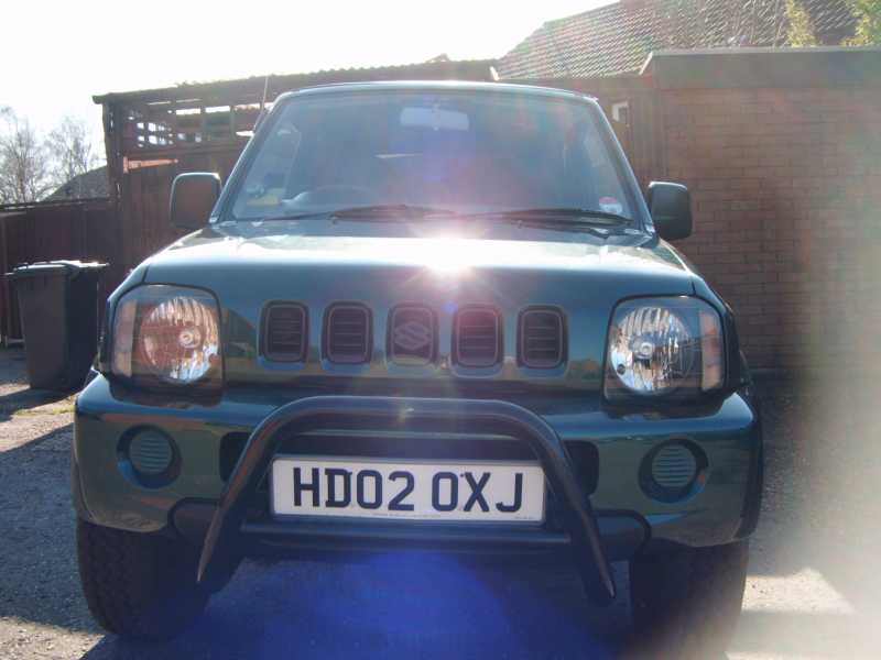

by Keefe
And I so wanted to fit it as well!
Not the same without the A-bar and the lamp hoops.
If I had a plate etc welded in so I could fit a winch, what then?
It's not a winch bumper at the moment, no mounting plate in it but if I had it beefed up to take one??????

It comes under construction and use and it's vosa that police that ,
Winch bumpers are fine but you may be asked to prove that you need the winch permanently fixed to the vehicle ! IE a "working vehicle"
bumpers after the said year (to simplify ) must be impact absorbing and present with no sharp or protruding edges, the later rule was was around long before. So protruding reccy points have been a no no for many years.
is it a silly rule ???? Ask yourself if you were crossing the road and the unthinkable was to happen, would you want the vehicle to have a modern soft impacting bumper or a big heavy lump of steel plate ??
and for a 5 year child old a jimny bumper would be nicely at head hight !
That's where this silly rule comes from ! Not so silly really is it.
Why not make a bumper that's good and solid and then make some soft clipon covers out of the old bumper ! That keeps everybody happy.
Even bull bars are legal if they don't patrude beyond the bumper/outer limits of the vehicle, and have an impact absorbing covering,

I dont think i put what i meant across very well :blush: . When i said A-bar i meant when fitted to a steel bumper. In other words, it sits at bonnet height.

Like all these laws you can probably get away with it until someone gets killed by a car with a steel bumper fitted and then the press whip it up into a firestorm. After that the police will be all over the situation.
Carnt someone make a cool looking winch bumper that has a bull bar made of something that looks solid but gives and actually would help protect a pedestrain if hit?
Nobby
