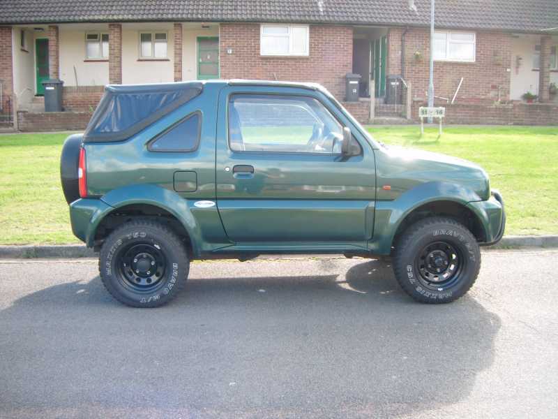

A 2" lift will be a better lift with 205/70/15 as you don't need to fit longer brake hoses,it helps to have
castor correction bushes fitted and a set of adjustable panhard rods.
This is my Jimny with a 2" lift tyres are 205/75/15 M/Ts.
Hope this helps you.

Replied by dirtydogz on topic Re: Lift kit - Help me
I was going to fit a 3" lift, but the Jimnybits 2" is a better lift to fit with 205/70/15 or 205/75/15.
As you can see in Paul4x4 photo you need a lot bigger tyres to fill the wheel arches.
