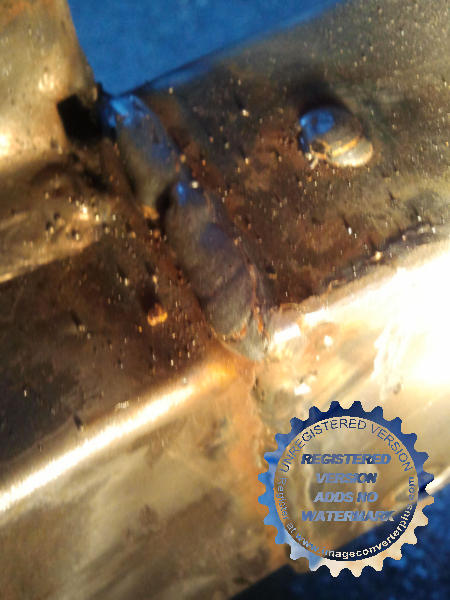

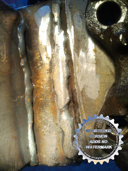

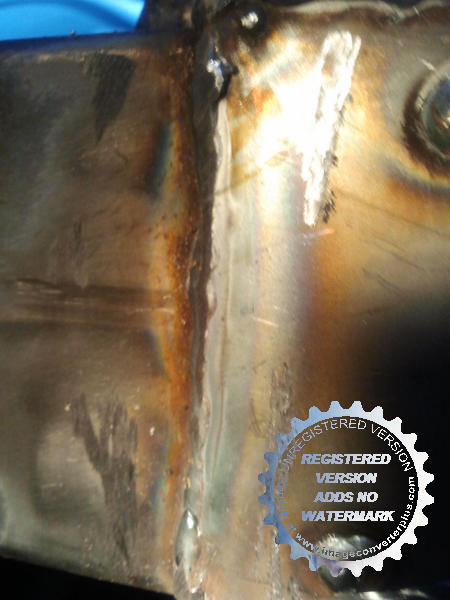

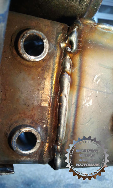

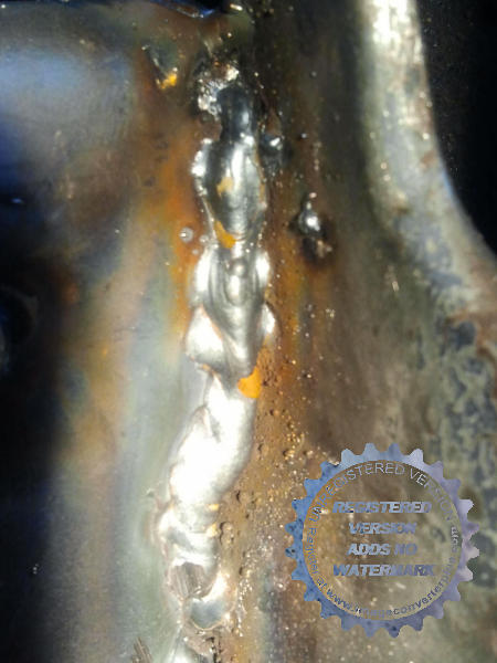

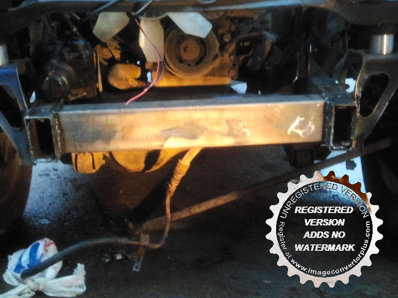

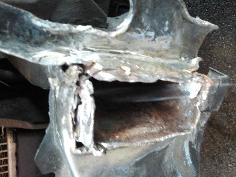

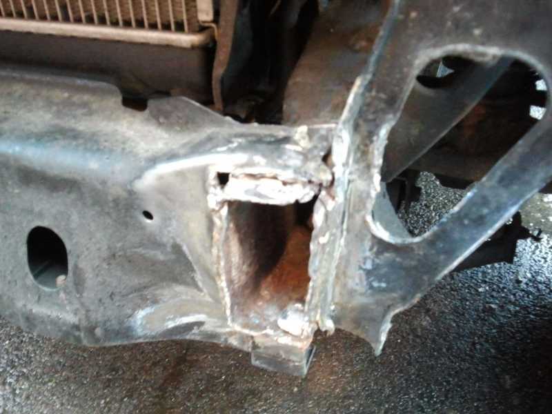

Well I've sleeved the chassis legs and welded in a 100mm x 50mm steel 3mm crossmember. Please feel free to add your comments on my dubious welding skills (I gratefully welcome your comments/criticism on whether you believe the welds will withstand the rigours of winching jim through the mud).
Some of the welds look good to me - others less so
Driver chassis leg outside:
Inside:
Passenger chassis leg outside:
Inside:
Inside/top:
Front View:
Inside:
Inside:
Inside/top:
Front View:
