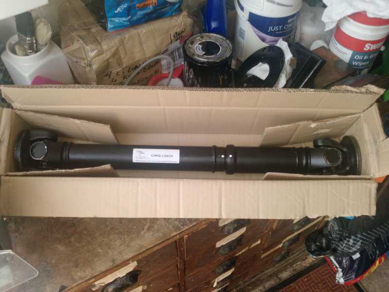

I had that problem on the front and got one from Camsuzuki breakers
alternatively you could invest in a heavy duty one
after breaking two rear props in six months we have a heavy duty (landrover spec) wide angle reinforced spline one we had made by Bailey Morris with the ends drilled for the jimny

- darthloachie
24 May 2012 12:25 #41084
by darthloachie
Replied by darthloachie on topic Re: play spline of my front propeller shaft
- Laminak

:woohoo:
It's a beautiful propeller shaft and looks very hardness model :evil:
