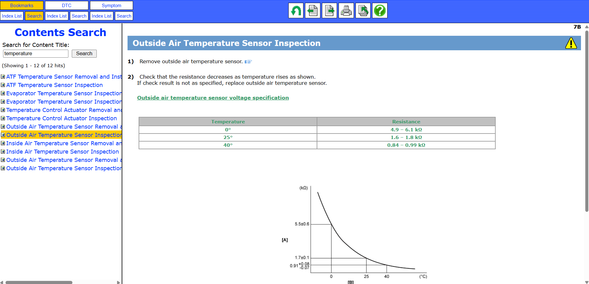

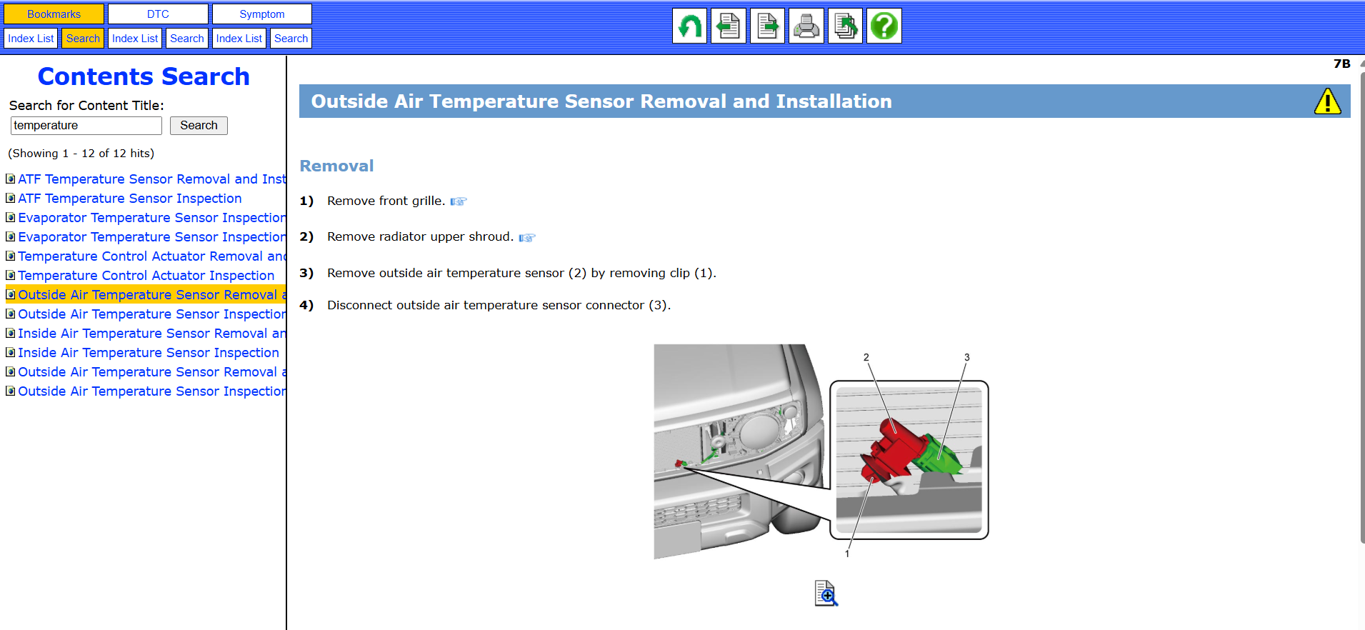

Where does the dashboard get it's temperature readings from? Mine seems to think it's 16 degrees outside which while it would be nice it's not true, it's nearer 28 just now. Is there a separate sensor dedicated to it that's easy to replace or is it an ecu derived reading from the air intake and a pain in the warranty?

Dunno I haven't had it plugged in yet. Thanks for the info.
