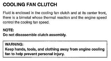

A 2002 Jimny should have an engine driven viscous coupled clutch fan, spinning whenever the engine is, no switch on or off.

Thanks but i already knew that but im switching to electric fans
