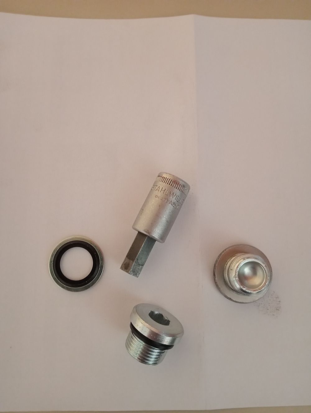

20 Feb 2026 14:37 #263844
by Roger Fairclough
I have been doing some research. Picture shows the original style diff. re-fill plug plus a Pirtek M20x1.5 male metric blanking plug plus a 10mm hex bit plus a Dowty washer. The Pirtek plug comes complete with it's own neoprene sealing washer (just visible) but may not be available separately - apparently no one has ever asked for one - but either use the Dowty washer or a suitable "O" ring. As regards drain plug which may or may not have a magnet, you can either put a button magnet on the tip of the new plug -it's made of steel - glue it in place or put magnet inside axle casing. As soon as it stops raining! I will try it for size. Plug cost me £4.80 incl.VAT. and is listed as p.no. 2007981
Roger
Replied by Roger Fairclough on topic Drain and re-fill plugs.
Roger

08 Mar 2026 09:11 #263937
by Roger Fairclough
The re-fill plug doesn't have a magnet, so I have fitted the Pirtek as a direct replacement. It was a simple replacement and tightened to 50 newton without a problem. In the intervening time there has been no leakage and no loosening, so I am happy with that.
Now for the puzzling part. The drain plugs are encased within a circle of steel that is welded in place and protects the plug from damage when the Jimny is driven over rough ground and as such is invisible to a cursory glance. You have to get under the axle to get a view of the plug. After fitting the Pirtek plug I had a look at the drain plug and found that it had a 17mm hex. head and not the Suzuki 10mm square hole. Due to my age, I accept that my memory may not be as good as it was and bearing in mind that I replaced the diff. oil some years ago I must have removed the plugs and re-fitted/re-placed the plugs that are now present. Question is, does Suzuki use magnetic drain plugs with 10mm square holes? I have looked through my spares box, but cannot find any.
Roger
Roger
