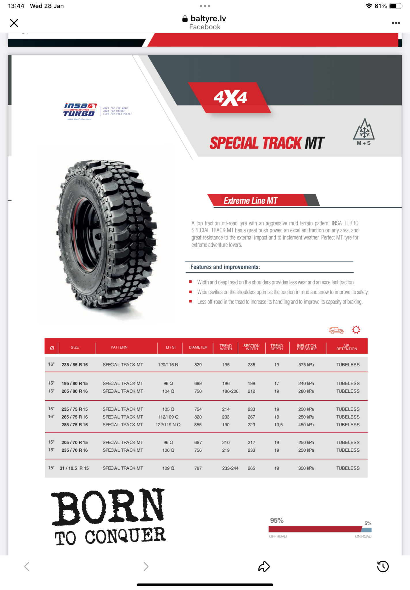

OK, a tyre size E.g. 205/70 r15, doesn’t give the overall tyre size but specifies the width, section band rim size, from which a diameter is calculated.
The diameter excludes the tread depth.
So my current tyres are Maxxis 215/75 r15 with 10mm depth, nominal diameter of 704mm so 724mm overall.
From the table in the photo 195/80 r15 Special track are quoted at 689mm, but tread depth is 17mm so 723mm overall, about the same as my current tyres.
The 205/70 r15 are quoted as 687mm and 19mm tread, so this is 725mm again about the same.
Interesting the section width of 195/80 is 199mm and 205/70 is 217mm, quite a bit bigger than standard.
On this basis I have decided to get 15” tyres, the 16” are probably going to be too big. Next job, measure my Maxxis accurately.

My Maxxis have just measured 795 or 800mm with 6mm tread, so about 788mm, a little under the nominal size of 704mm + tread.
My choice comes down to two sizes 195/80r15 or 205/70r15, looking at the size chart above, both are about the same diameter 687mm, but I think this excludes the tread with is 17 or 19mm deep.
Overall (inc tread) both Insa tyres should be 25mm bigger than my Maxxis.
I am leaning towards the 205/70r15, mostly because it is a Special Track 2 tyre rather than the older design, although I am struggling to find out what they changed.
Given that this tyre is wider than specification, it should be nearly as wide as my Maxxis.
Robin

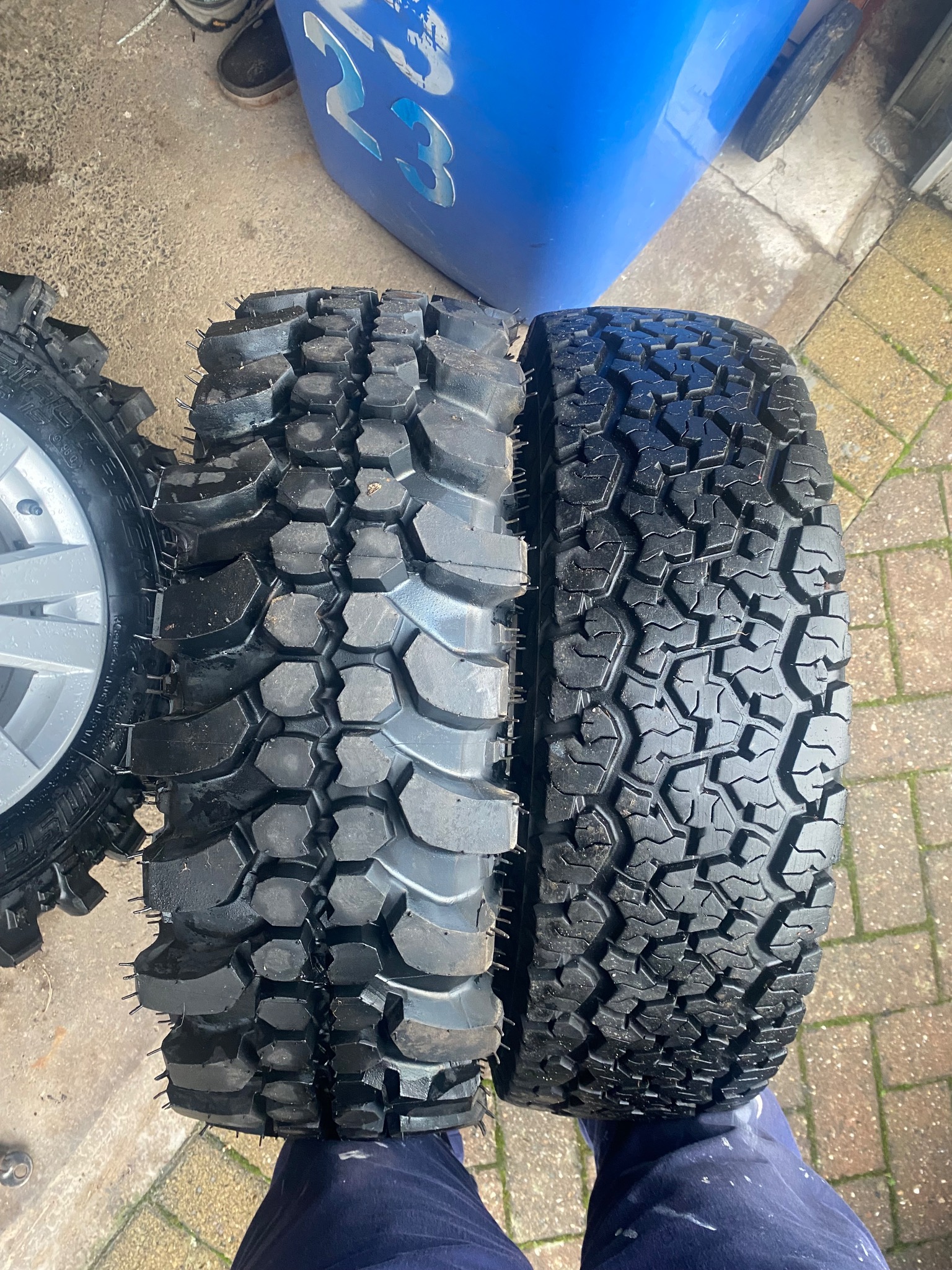

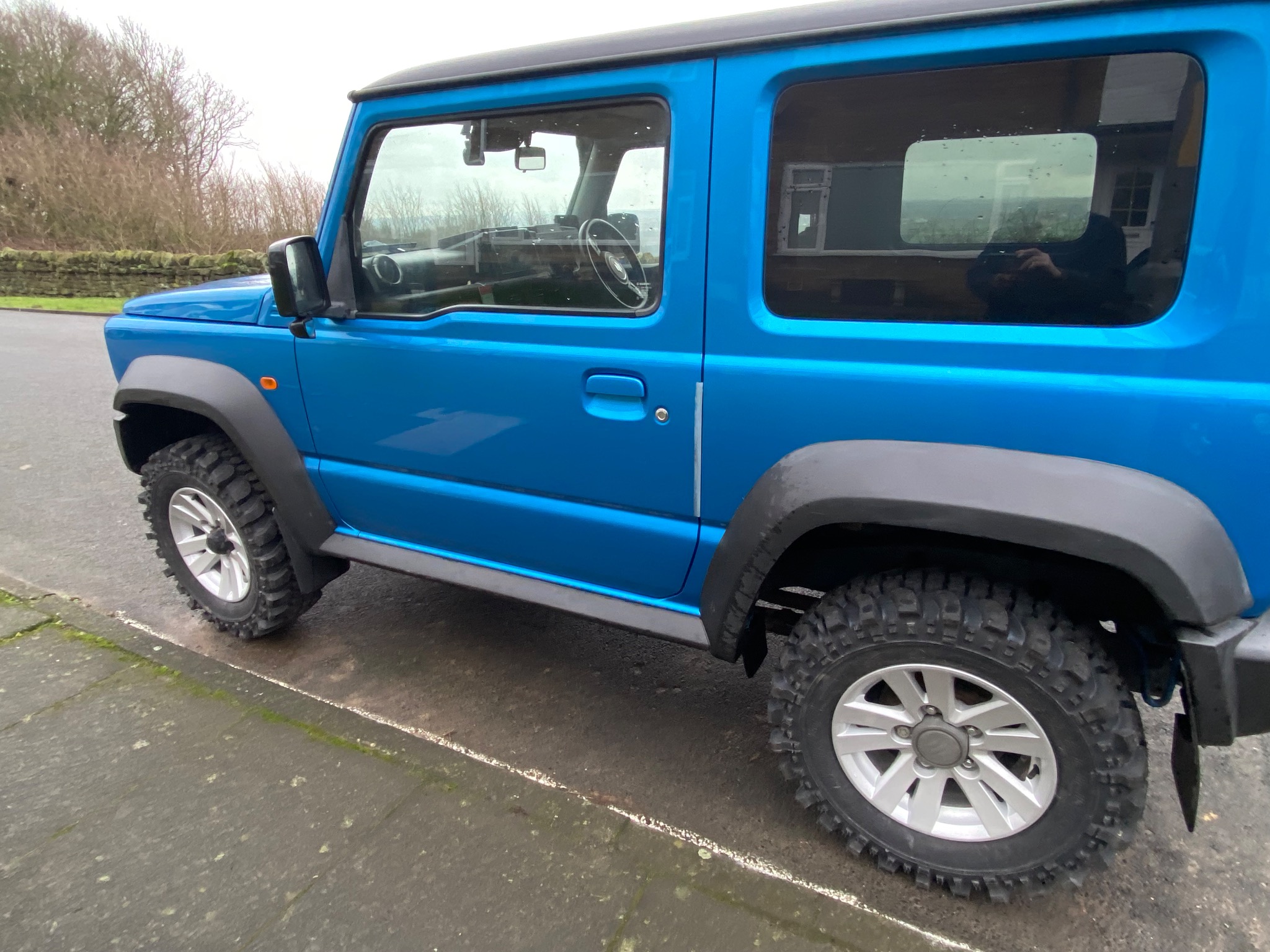

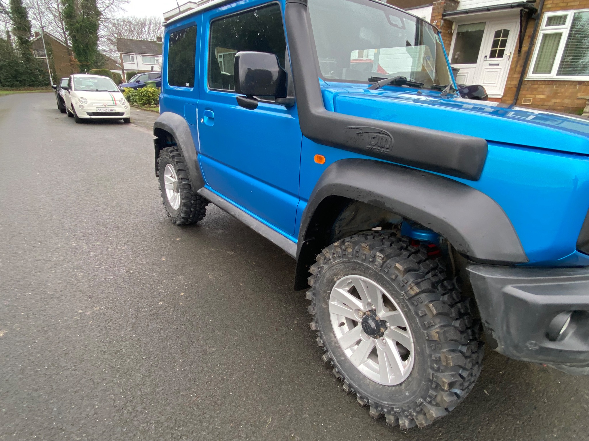

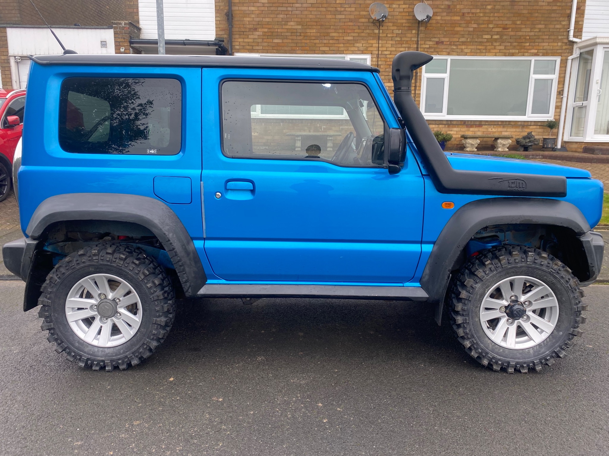

Special Track MT2 fitted to my spare wheels and confirm they are a little bigger.
Fitted to the Jimny
A test drive confirms no balance issues (i put beads in) and no pulling under acceleration or braking.
However, they are a bit more noisy, they jump off white lines, the ride is fairly firm and the car drinks fuel, i can put up with that for off road.
