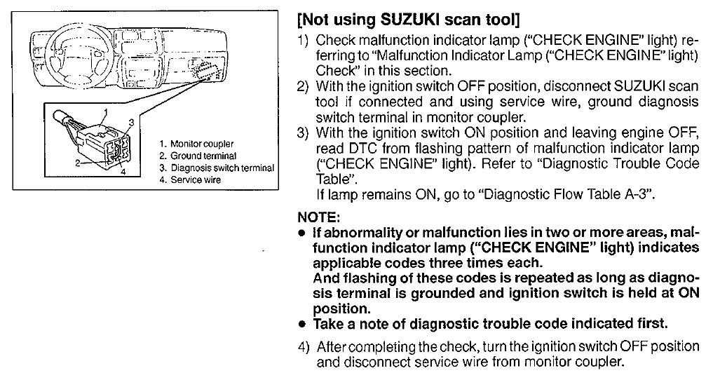

First - if there is an immobilizer fault there should be some sort of dash warning light to indicate this, look at the dash lights & check your owner's manual
Second - 1999/2000 will usually not respond to an OBDII reader, but can be diagnosed using the check engine light and a jumper wire in the monitor coupler.
What lights are on when you switch the ignition on before trying to start the engine - do you have at least the oil pressure light, the charge light and the check engine lights?

As suggested bridge the diag port and read the flashing code.

I have absolutely no idea how to do that, what pins to “bridge”.
some assistance in how to do this would be greatly appreciated.
