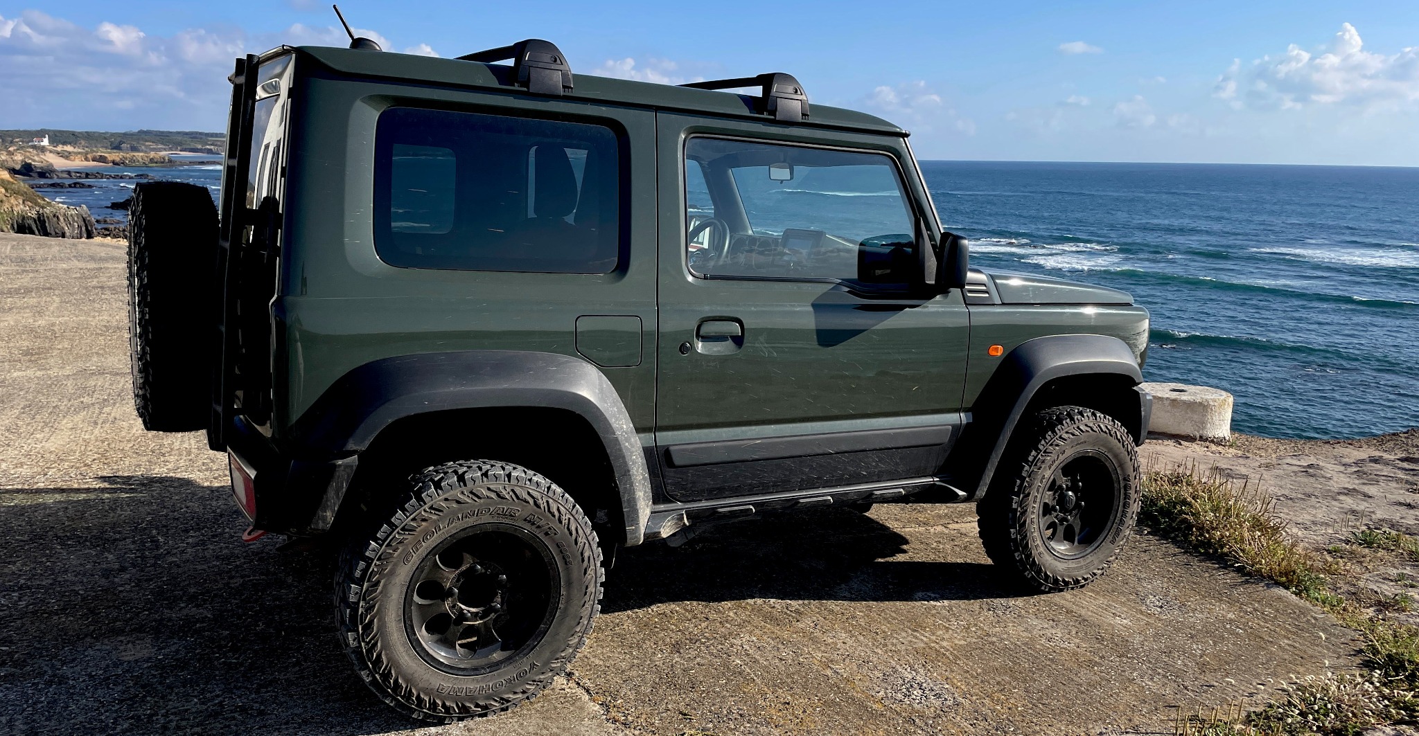

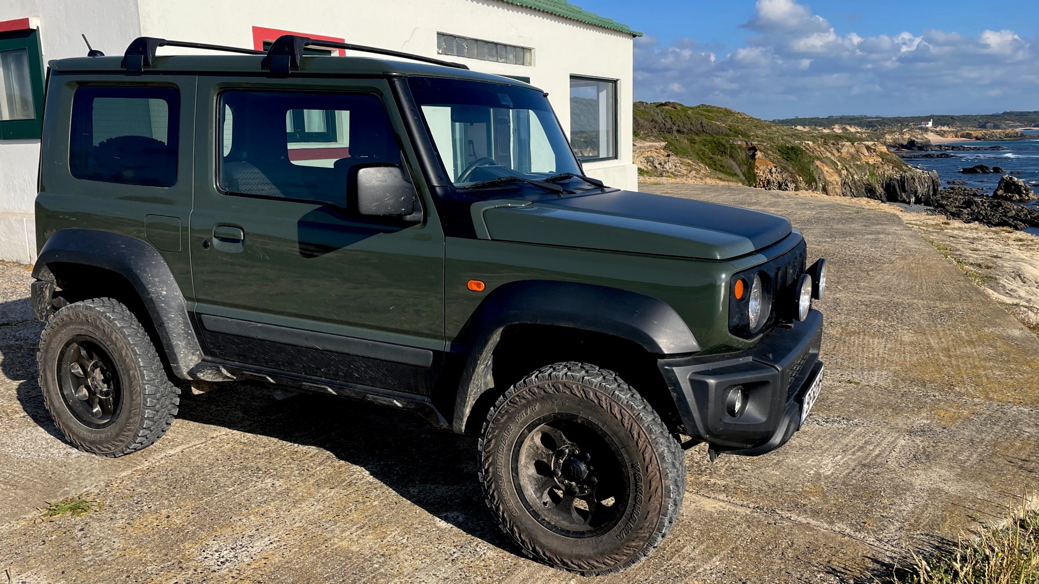

13 Nov 2025 21:49 - 13 Nov 2025 21:51 #262734
by Filipao
Replied by Filipao on topic Suspension lift
Edit: I have the castor correction bushes.
Last edit: 13 Nov 2025 21:51 by Filipao.
