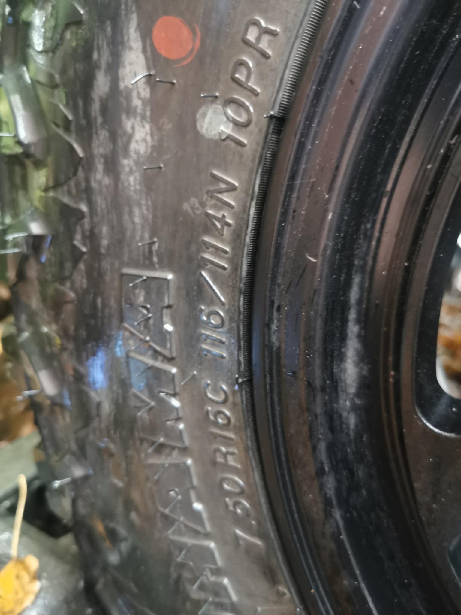

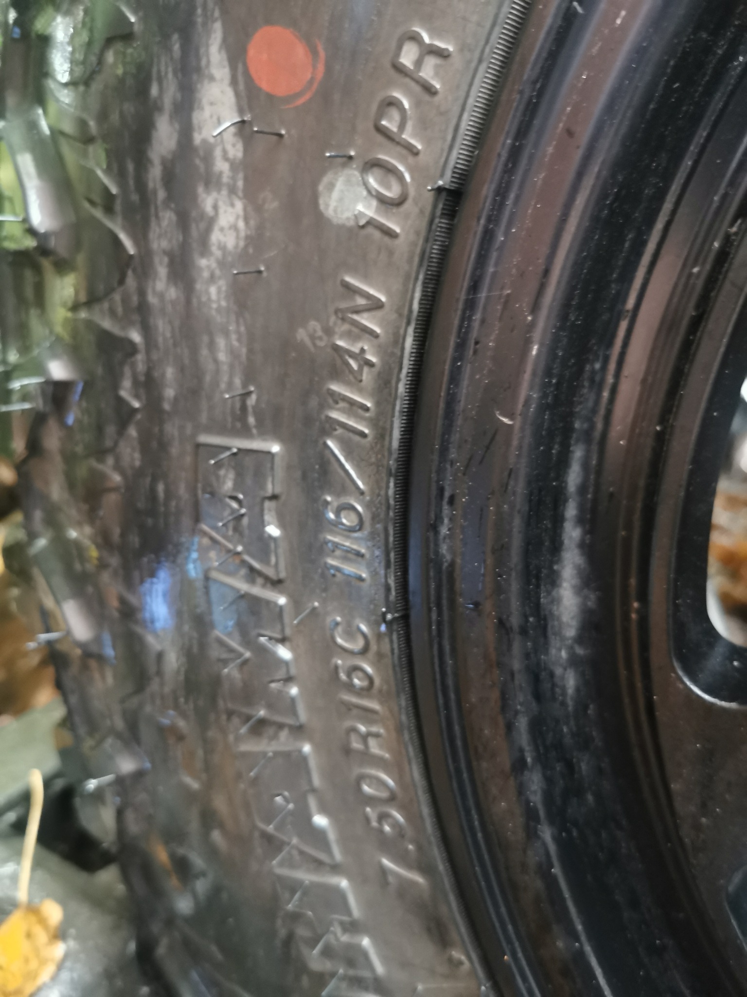

Big heavy tyres here 28.6kg
Mine is more a toy mainly driven off road and I like the side wall strength for peace of mind.
Fuel consumption is bad at 20mpg
