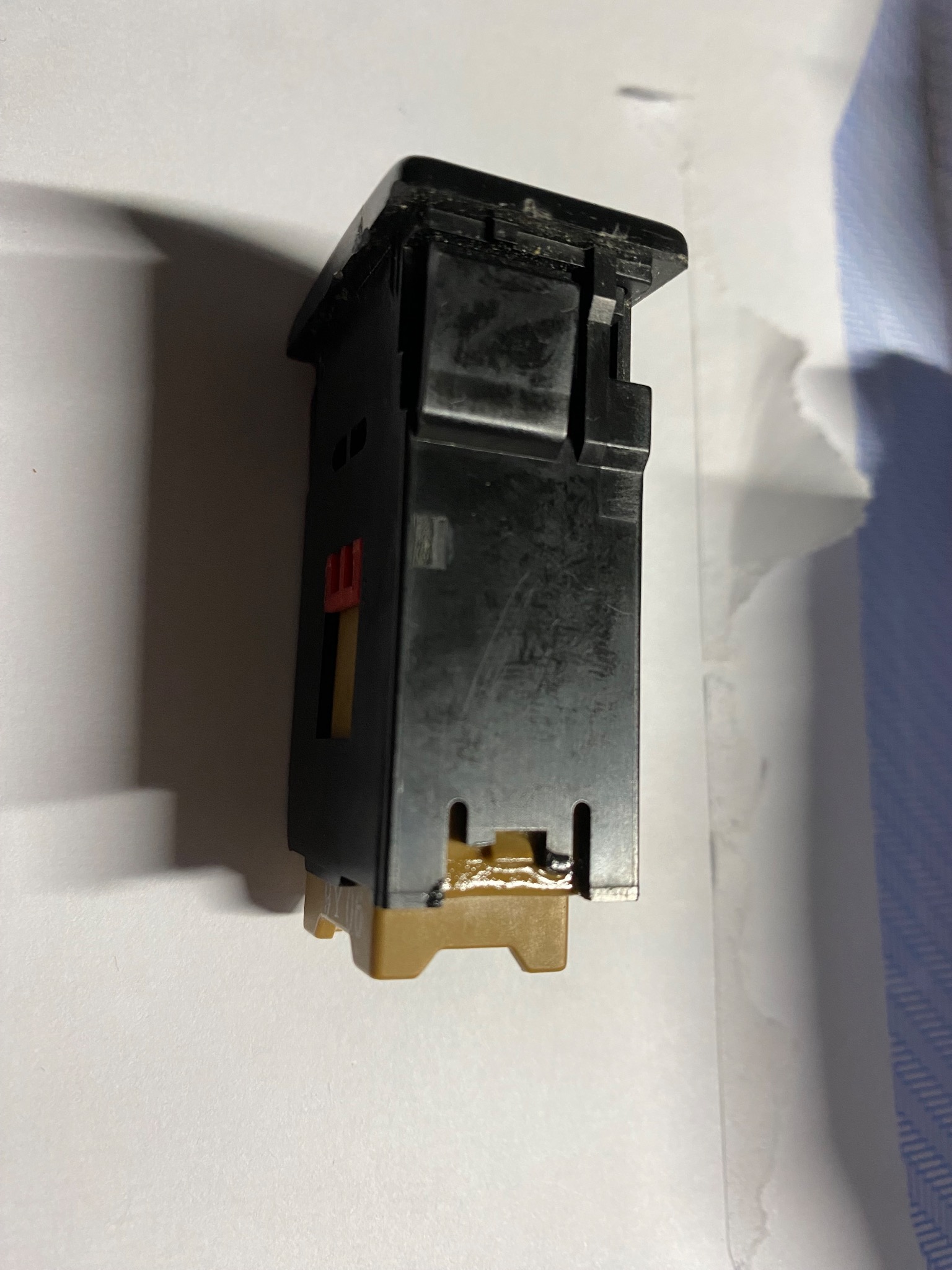

Funny you should post this about heated seats, we went out for dinner tonight, it was a bit nippy and I offered to put the heated seats on for the missus, only to find her side didn’t work, but my side was fine.
The atmosphere in the car was a bit frosty, but after fiddling with the switch I decided it was the switch which was broken (the light didn’t come on) so when we got home, took the switch out and found it had come apart.
I have recovered both parts of the switch, it will go back together if I glue both halves together, but I lost one of the bulbs in to the bottom of the car.
Before I strip the car down to find the bulb, does anyone know if you can buy the switch on it’s own, if it’s not a fortune, I will go for a new switch rather than trying to fix the old one?
Ta
Robin

There's a 99.9% probability the switches are available separately, and I dare say that Martin probably has access to the parts catalogs and can probably supply, if not let me know and I'll see if I can at least get you a part number that can be ordered from a dealer.

I can't remember the price but you can easily buy the switch, I think I might even have a new switch here somewhere.

I recovered the bulb from inside the switch, it had fallen down near the hand brake and then glued the parts together where the original thin bit of plastic held it together, bottom of this photo.
There isn’t much plastic holding the switch together, so it might be a weak point.
Robin
