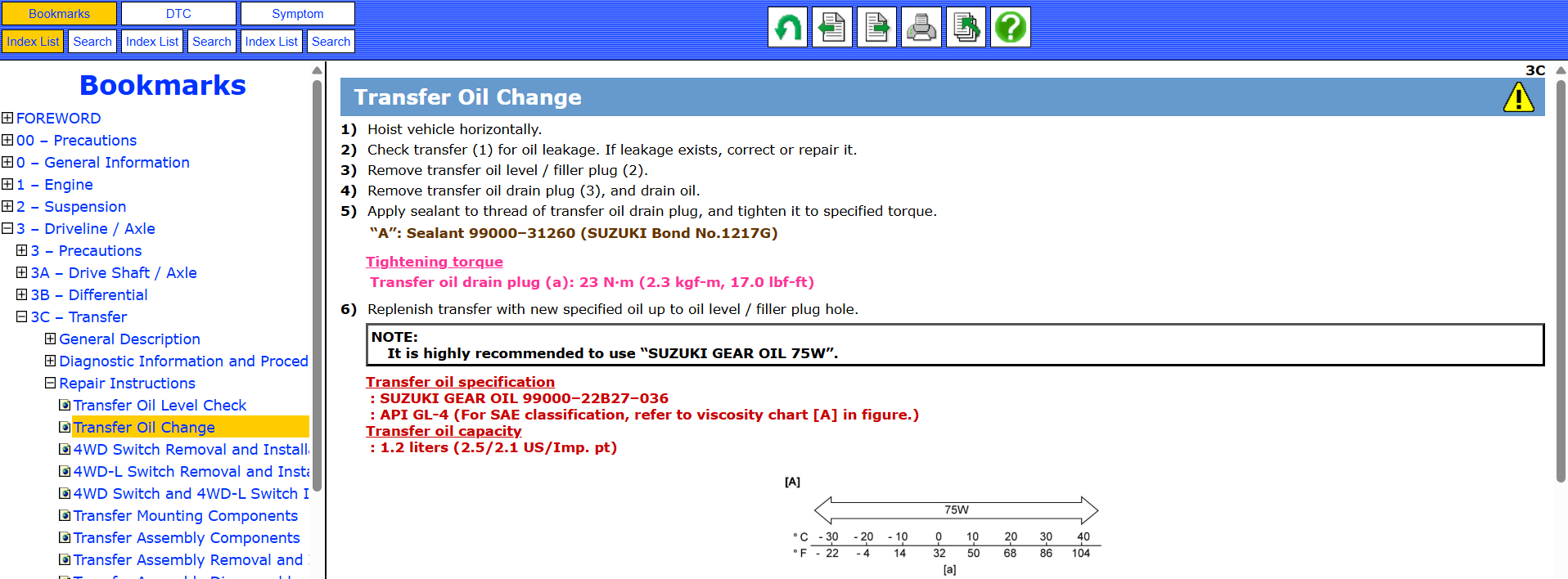

24 Oct 2025 17:09 #262450
by fordem
Replied by fordem on topic Transfer box oil?
OK, now that I've learned WHERE to look in the FSM, I can find the detail I wasn't seeing earlier.
