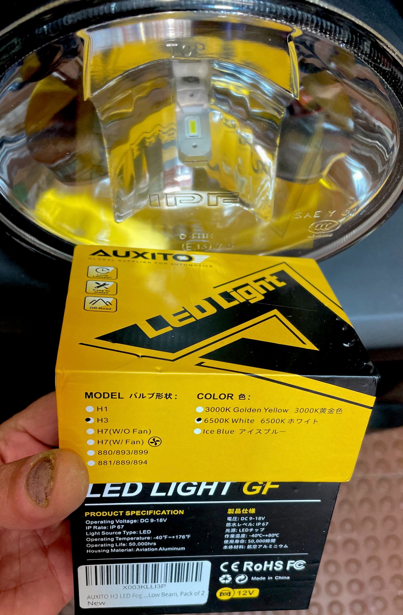

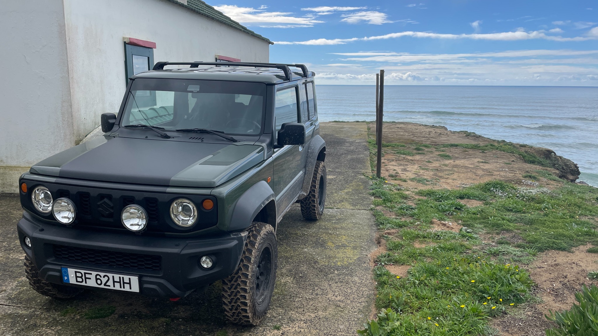

My JB74 LED headlights in "auto" mode work better than my Audi's LED Matrix. Stunning, really.
Low beam has been adjusted to be low, as @DrRobin did.
High beam is unbeatable with this IPF setup, fitted with H3 LEDs from Auxito.
