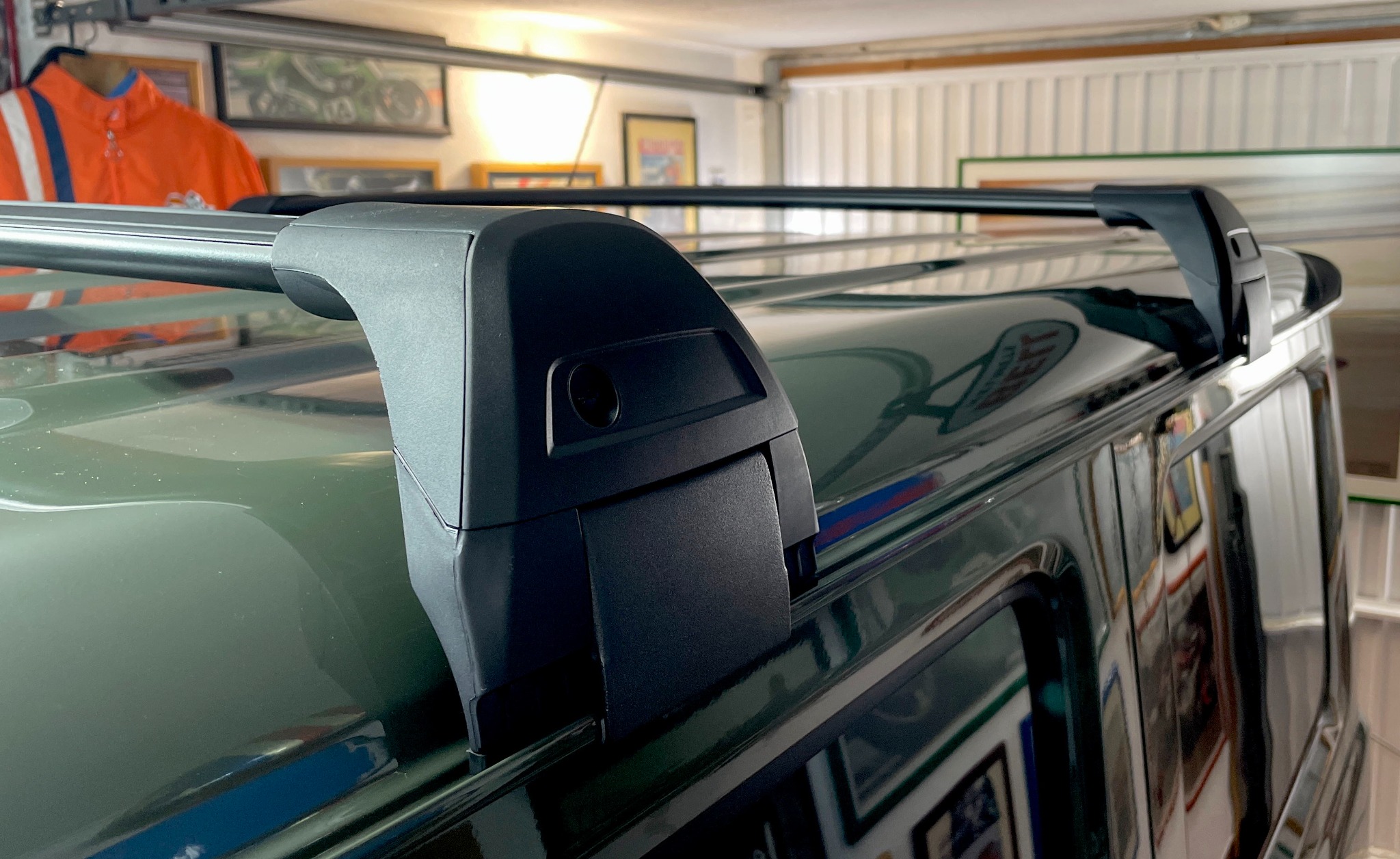

2) Looking for a functional but economical roof rack. They sell a simple one over here and in AliExpress. Just sort of flat. Mounts to the drip rails. Any recommendations?

Welcome to the forum. The main reason for a lift on a jimny is to fit bigger tyres to in turn raise the axles away from the ground. The thing there is that if you go to the limit of the standard gearing with the bigger tyres they will just about fit under the standard suspension. Also with a 2 inch lift the front propshaft interferes with one of the chassis cross members so you need a kit that moves said cross member or go for a 40mm lift. As for roof storage systems they are all essentially cosmetic as the roof load limit is 30 kg including the roof system aka practically useless.
The Jimny has a relatively low roof load, so I suggest you go for a very light roof rack or simple roof bars. It depends what you want to carry, but the roof load is so low in my opinion it’s not worth fitting one of the full length racks and I would just go for something basic, light and therefore cheap.
