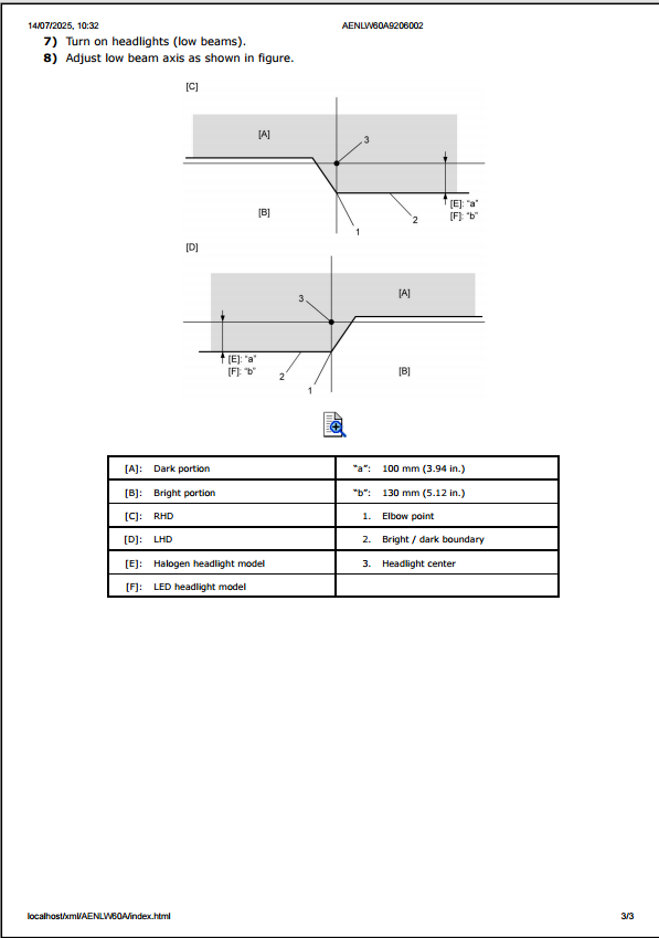

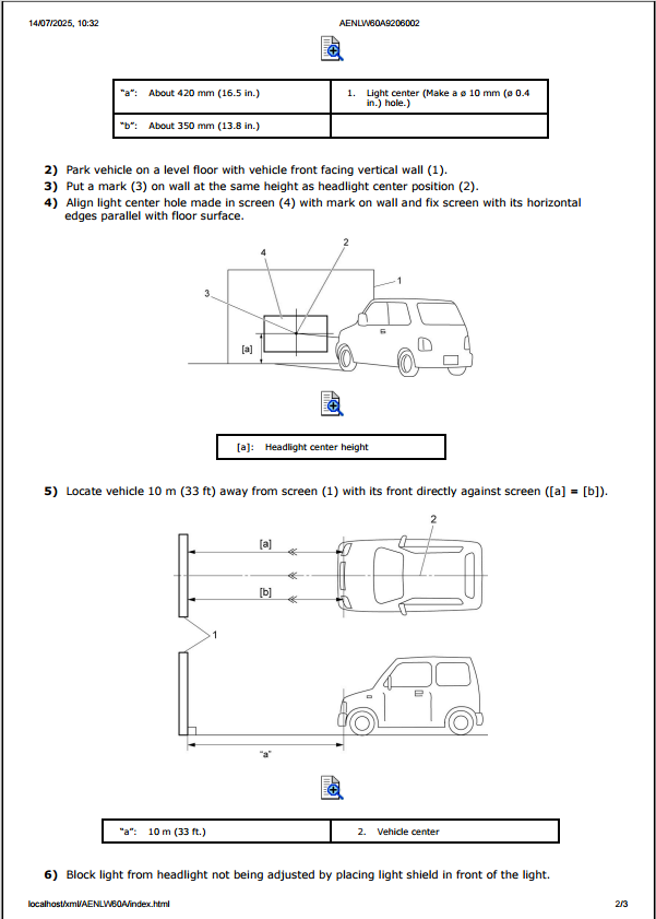

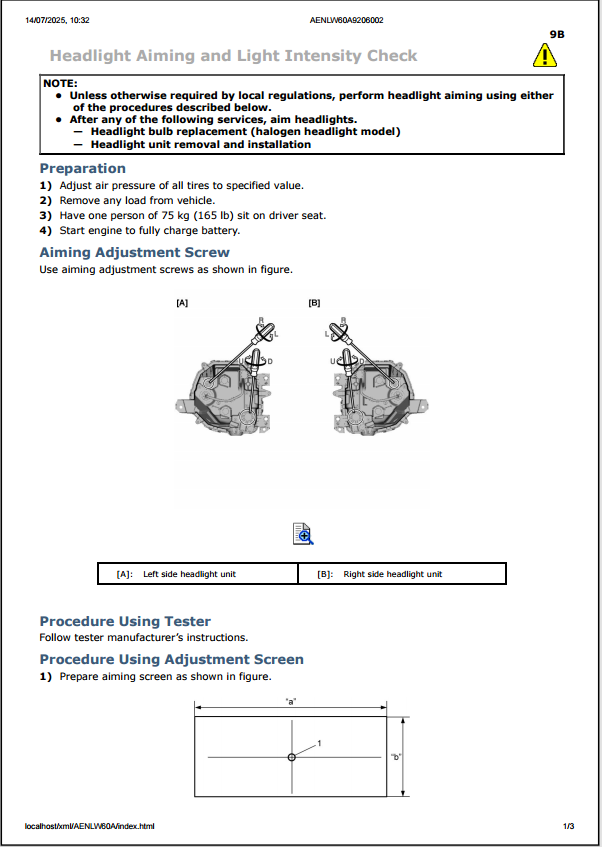

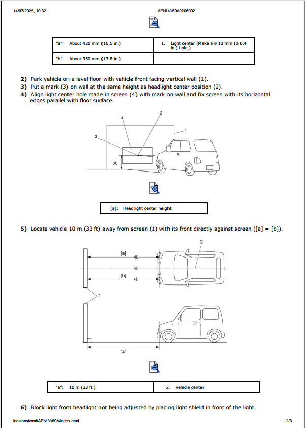

14 Jul 2025 09:39 #261218
Replied by Soeley on topic Upgrading JB74 Gen4's LED Projector
The following user(s) said Thank You: SaltigaGT
