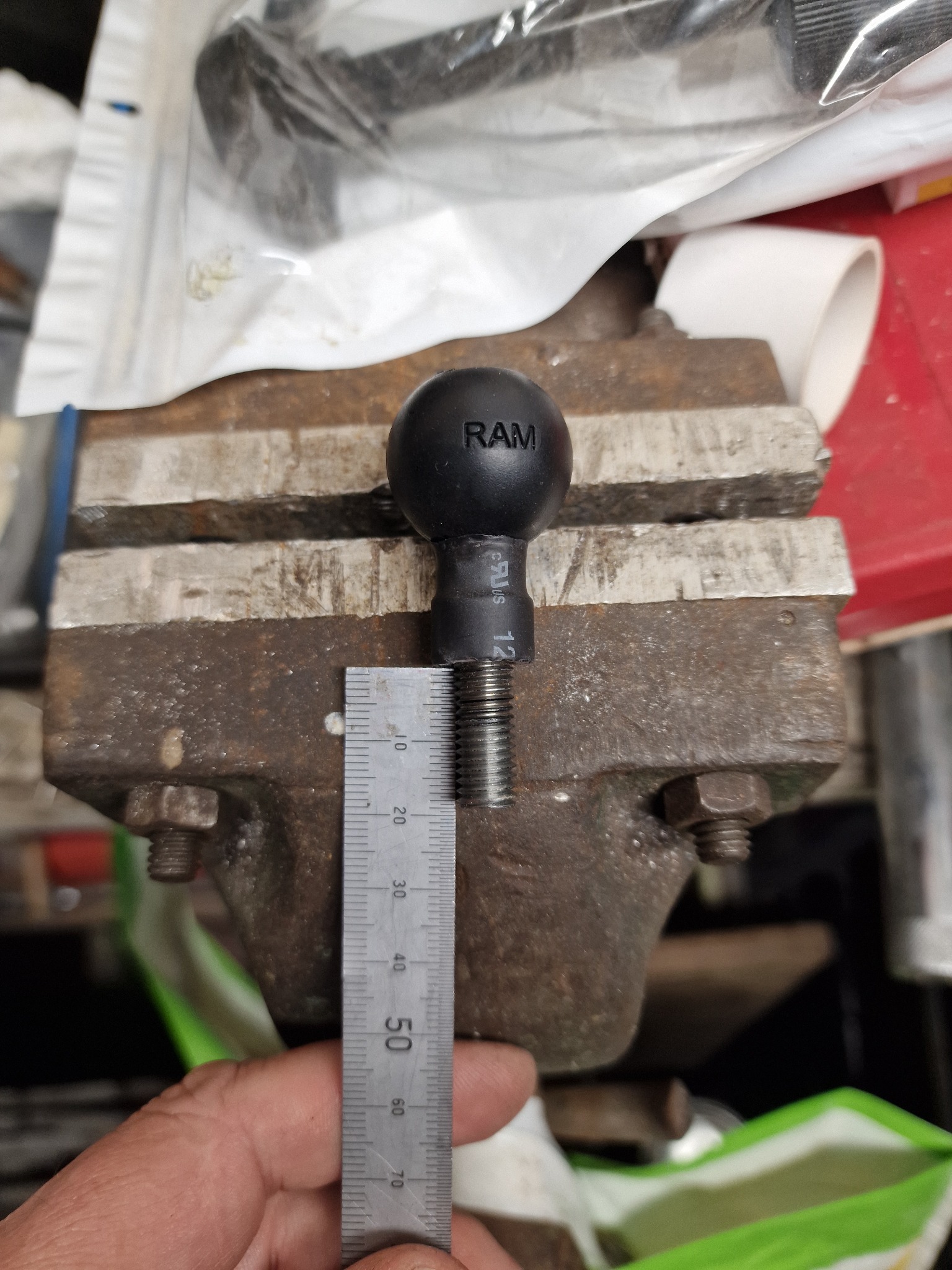

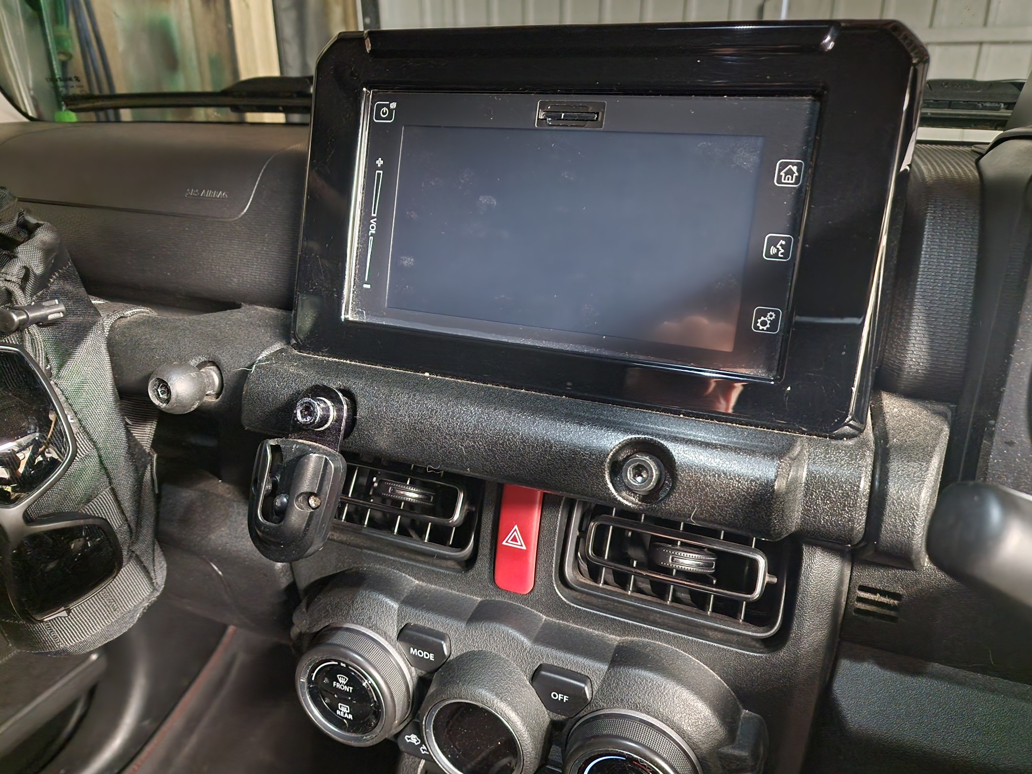

I have a 25mm RAM ball screwed to the grab handle. The thread is M8.
There is also the aftermarket under the radio trim the has two real bolt hole. My CB mike mount is in one of the holes.
I put some black shrink sleeve on the boss as it was just ally and stood out too much.
I had to run a die down as the plain shank was too long.
