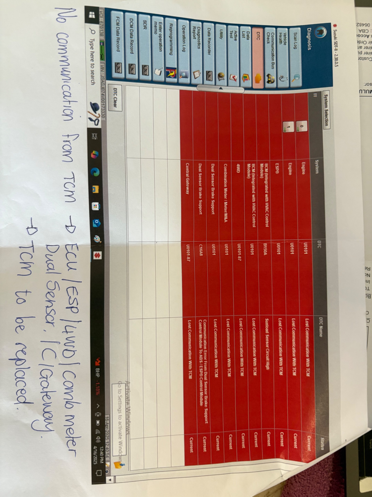

I have a 2 door 2021 model jimmy ! Repairable writeoff ! All front impact damage no just panel damage ? Driver and pass airbag deployed ? Both airbags replaced and all seat belts ! Including airbag module all fault codes for Abs erased ? Now left with no communication with TCM so I replace TCM with finer vehicle exact matching numbers from no fault car ? But cannot get rid of fault codes , Suzuki telling me I need to buy a genuine TCM from them @ 2300 smackers ! Wreckers are adamant there TCM was fine when sent ! Need help before dropping pants at Suzuki

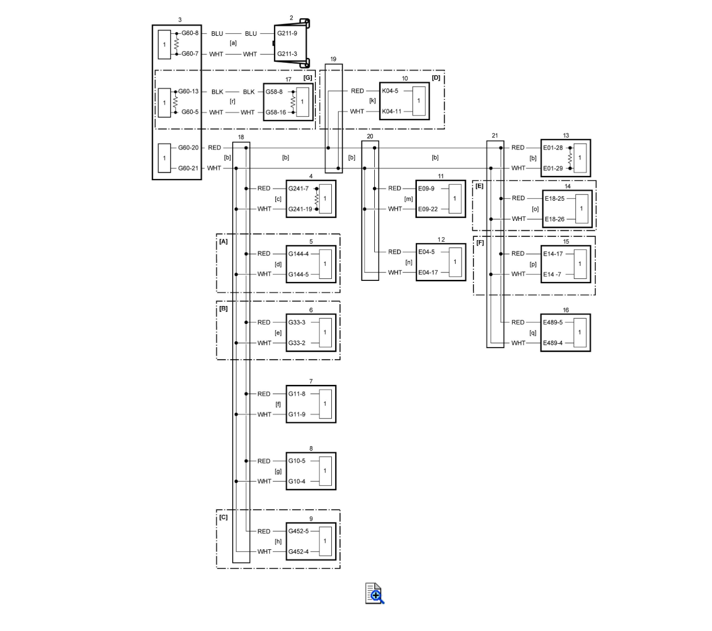

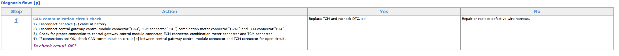

No comms at all suggests a wiring or more likely plug connection issue either something got cut through or just not plugged in. Also might be a fuse.
17 Apr 2025 14:13 #260151
by fordem
Replied by fordem on topic No communication with TCM
Maybe start by checking for power & ground at the TCM.
