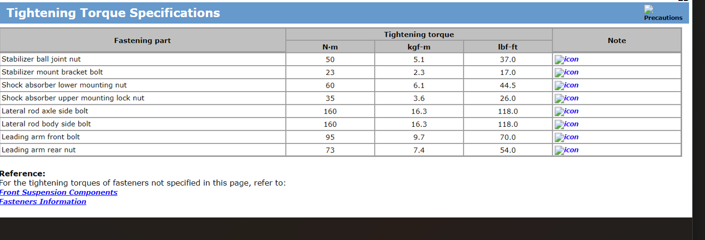

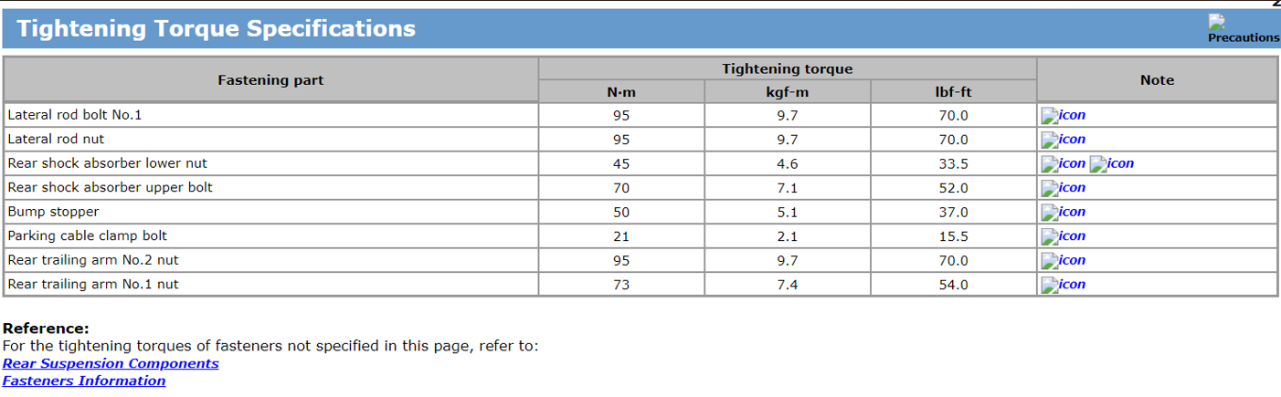

Hi . About to upgrade the OEM shocks for some bilsteins on my gen 4 jimny . . Does anyone know the torque  setting for how tight I need to re tighten the bolts. Any other useful tips greatly appreciated. Going for the extended shocks on standard springs incase I ever decide lift in the future?

Hi, these are screenshots from the Workshop Manual.
Front
Rear
