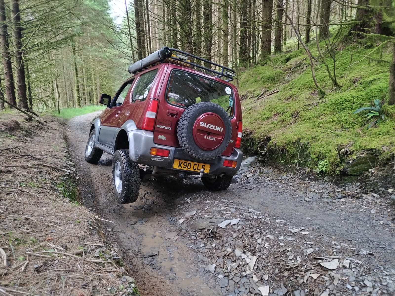

I have spring spacers on mine, had them on for about 6 years now. Didn't bother with the shock spacers, bought longer shocks. Ride on road is no different really, and I get plenty of flex on the lanes.

Rear wheel will happily go into the arch, enough movement for what I do! Will get longer springs when an original gives up.
