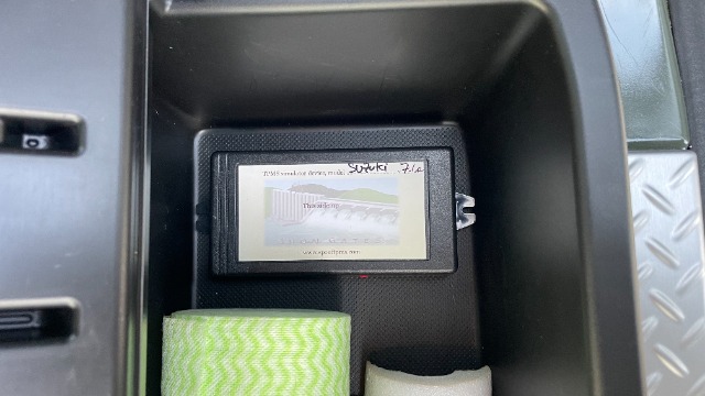

Get rid of all sensors, be free to change pressure whenever needed/wanted.
Replace them by the Iron Gates module.
Mine has > 1 year and is perfect.
spooftpms.com/setup-instructions/

Glad the TPMS spoofing device works for you. But don't you miss the nuisance ?
Got the native TPMS disabled on your Jimny but still want to monitor tyre pressures? Take a look at this device accomplishing just that!
It monitors individual tyre pressures and temperatures **without** the need to install aftermarket sensors, Techstream laptops or OBD2 bluetooth dongle + smartphone.
spooftpms.com/suzuki-tpms-monitor/
