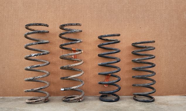

I picked up a set of used Gen 3 Jimny springs, these were removed when a Black Raptor lift was fitted, not because they were defective.
When I took a closer look, I realized that one was shorter than the others - I was expecting two pairs of springs of similar free height, one pair for the front and the other for the rear, and my expectation was that each pair would have a similar free height.
The shorter spring has the same number of turns as it's partner, and does not appear to be broken, it's just shorter, possibly sagged, but, my experience with sagging coil springs has been that they sag under load and the free height is not affected.
Is what I'm seeing here normal, does the third gen Jimny have one spring noticeably shorter than it's partner?

It's normal for Gen 3 and Gen 4 RHD Jimnys use an odd pair of rear springs to counter the Jimny lean. I've never noticed that much height difference though. Normally on a Gen 3 the NSR spring is similar height but has fewer turns of thinner wire. That said there are a couple of different part numbers.

As previously mentioned, there is a difference between the stock left and right hand rear springs, however it is not normally easily visible. The springs usually look pretty much the same.

The Black Raptor +2 kit uses different weight front springs - a 1000 for one side and 1100 for the other (back springs are both 1500s for the BR kit). They are slightly different heights too.

I think every lift kit for RHD cars uses different length front springs, but that is a distraction from the topic here.
I fitted gen 4 springs on my gen 3 recently (thanks Martin) and they seem to be the same as gen 3 in terms of ride height and firmness. I will look tomorrow to see if the dots are easily visible.
